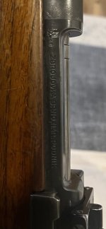

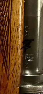

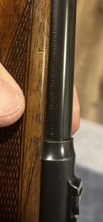

Good evening everyone, I was hoping someone could give me a hand to help. Identify what I have with the following rifle. I picked the rifle up in trade and would love to shoot it, but there is no way to add optics to it. To me it looks very much like a model 21, but it doesn’t have the integral site rail. Any thoughts?

Hello All! Im new to this site, but I need help identifying my Brno rifle. The model and caliber. The serial number is 22*** with FHC stamped under it. It has Zbrojovka Brno Narodni Podnik stamped, but I can't find anything with the caliber. It is a double trigger, appears to be a long action, and has the butter knife bolt handle. Also the stock doesn't go out to the end.
Hard to say without photos, but it sounds like a 21H. Does it have the round top or double square bridge?
It looks to be a 1948 manufactured Brno 21H with the round top. Very nice rifle you have there. I do see that the rear sight blade was removed and replaced with a marble brand insert? Is it drilled and tapped for scope bases? it's hard to tell in the photos, but is that the factory single trigger?
