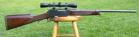

Browning BLR in ROUGH shape.
So I took the darn thing apart today... I see why people say not to.
I'm glad I did, there was literal mud inside of this POS. Wtf. Guy must of used it as a paddle in the marsh.
What's crazy to me is that they dont have timing marks on the spur gears... would help with assembly, even at the factory.
I will try to figure that out so its easier in the future to clean.
I stuck the bore scope in to try to see how the barrel is threaded into the extension, but still have no idea.
I'm definitely worried about the bore picking up a lot of copper and creating higher pressures after 20 rounds.

I've seen that video, the guy talks way too much.
He doesn't put the gear in properly, he just keeps trying it. Nothing wrong with that.
But he never mentions that the spur gear has two different counts of teeth. So you can't just put it in and rotate it until it fits, because if you go 180 with it, it will engage the rack very similar to the other side, but about .020" different. You cant really feel it, but there would be play. Kind of scary. I'm going to use a dial and double check the bolt is seated all the way forward after assembly.
It's actually crazy, what a dumb design. All it needs are two dots like a timing set on an engine... that would solve everything.
Hunterhenderson has a pile of experience with the Browning BLR platform rifles. He may be of assistance in the timing or reassembly of these challenging designs.....:)
They are pretty finicky for sure, there certainly are some tricks to it, I duct tape the bolt in when you are installing the gears, if you dont it will almost always be out a few teeth and wont shoot
Can you think of a reason why having timing marks would not work?
Duct Taping the bolt shut is a good idea, masking tape is for people working on other people's guns lol.
