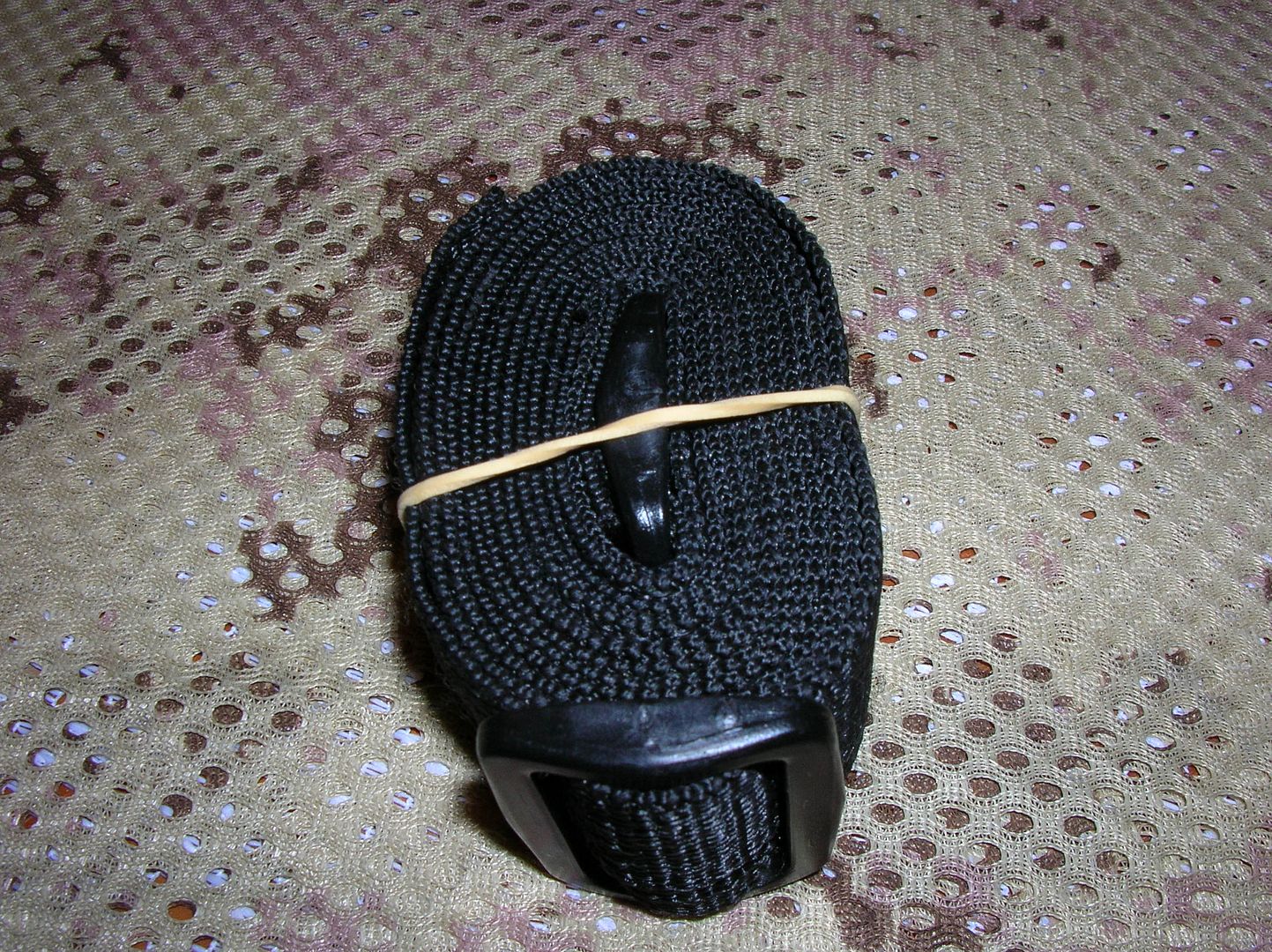

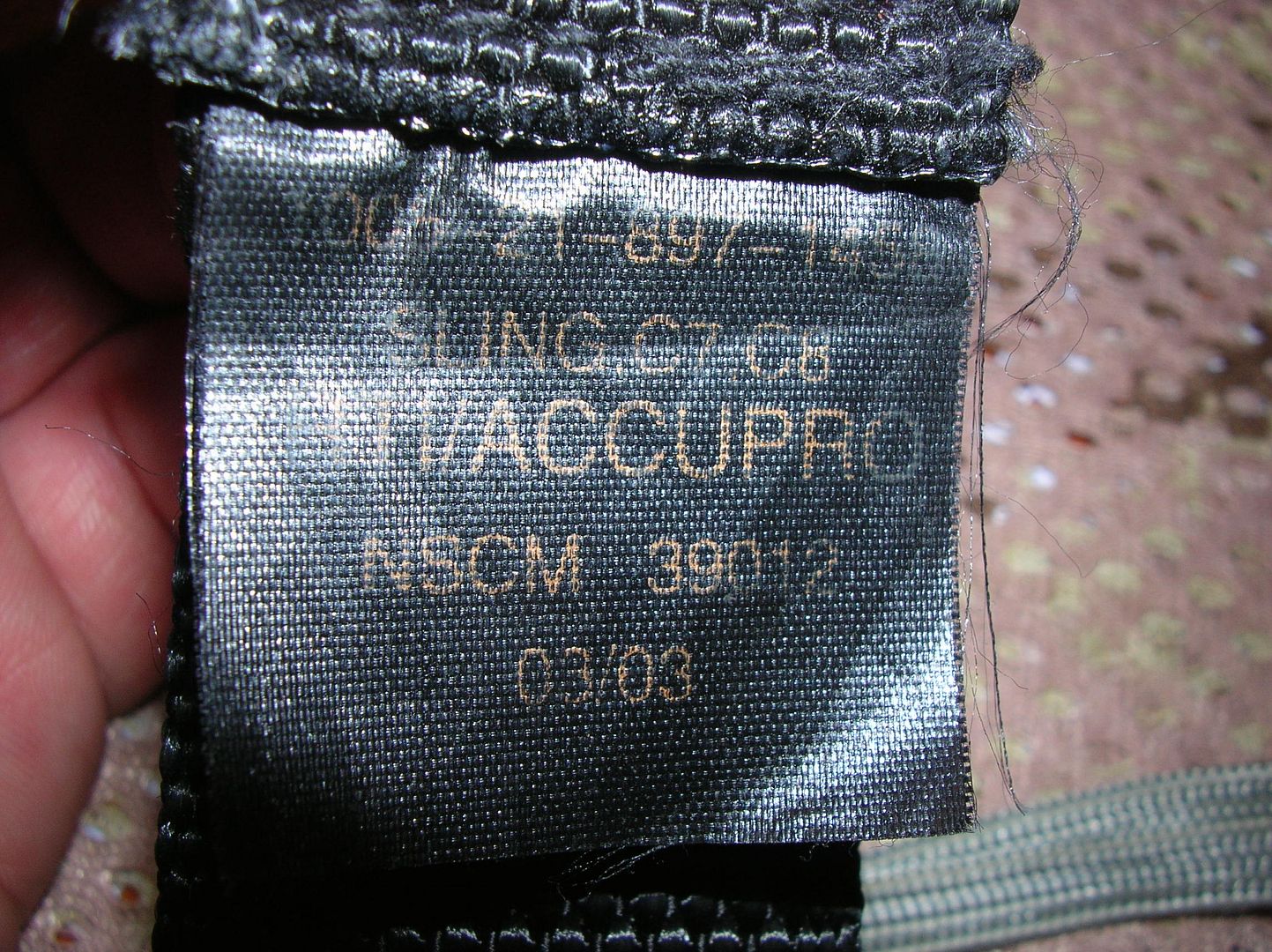

I just lost an evilBay auction for one at $90 US a few days ago--next best rifle kit listed is $260.
