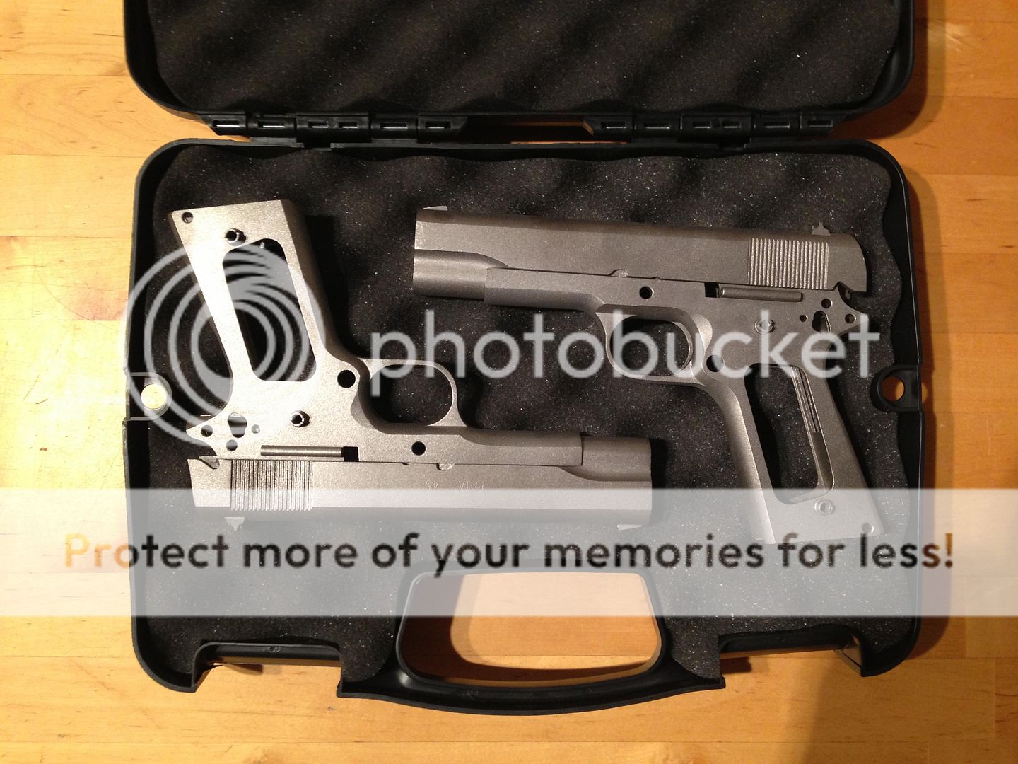

Here are the 2 new norcs already sandblasted. Im only doing the slide and frame on these 2. One in all black, one in all FDE. Ill post up pics of the finished products. They are already sold to members here on the forum.
Just finished the Arma-coating process with the 2 guns pictured above. One in all black, one in all FDE. I added 4tsp of reducer to the mix and it really helped even out the finish coming from the Prevail sprayer. They look great. Ill get some pics up later tonight.
