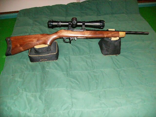

bbl choices
Don't get me wrong, I like the bull bbls as well. I have 4 10/22's that sport bull bbls, 3 GM 16.5" ers, a Whistlepig 18 incher with comp, an 18" stainless GM second, a 17" Boyd's special, an ER Shaw 18" stainless. I have a set of 20" bulls for my 77/22. I have no shortage of bbls, but lately I've been trying to get the most accuracy out of the factory barrels as the rules have changed getting them here. Here is how a factory bbl can look; still messing with the bedding trying to wring some accuracy out of it though. Note; bbl is just blued, lighting in pic makes it look funny.
