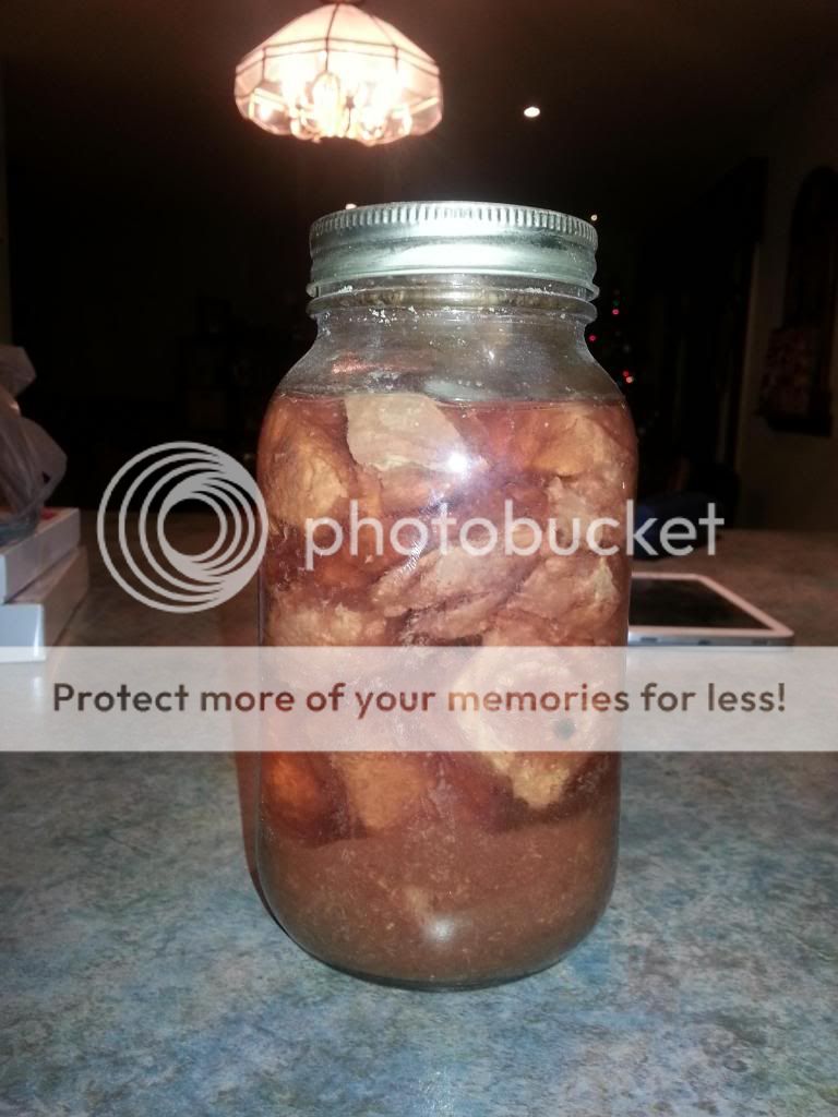

Here is some canned venison. We have been doing it for years and it is awsome. We do it in open water. Put this in a cast iron pan with sliced potatoes and carrots and thats as good as anything is gonna get.
