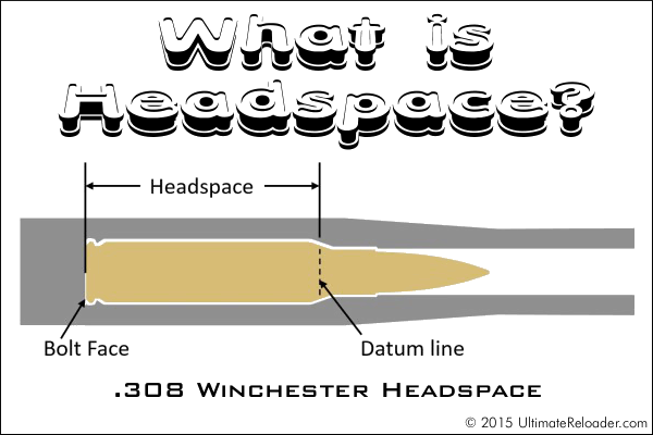

There are many ways to measure head-space in the industry. In my quick observation I was referring to this kind of head space. Not belted cartridge which is different. I still think you have oversized chamber space as indicated in below pic as 'headspace'. If your chamber space is within specs then try polishing it to a mirror shine finish.
The way I see it is a headspace gauge won't detect a problem but a go/no-go might.
This pic is not valid for a belted or rimmed case. Headspace for belted or rimmed cases goes to the forward edge of the belt / rim. As the belt / rim is part of the chamber reamer, the distance from the belt / rim to the shoulder will remain fixed.
Yes, it is possible to size fired cases to "headspace off the shoulder" but that does't work for the first firing, which is where the OP is experiencing difficulties.
