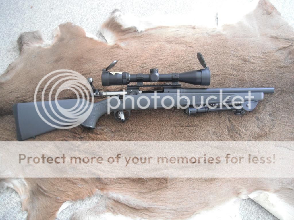

here is some from this weekends range trip.
was very cold but was able to get out and have some fun.

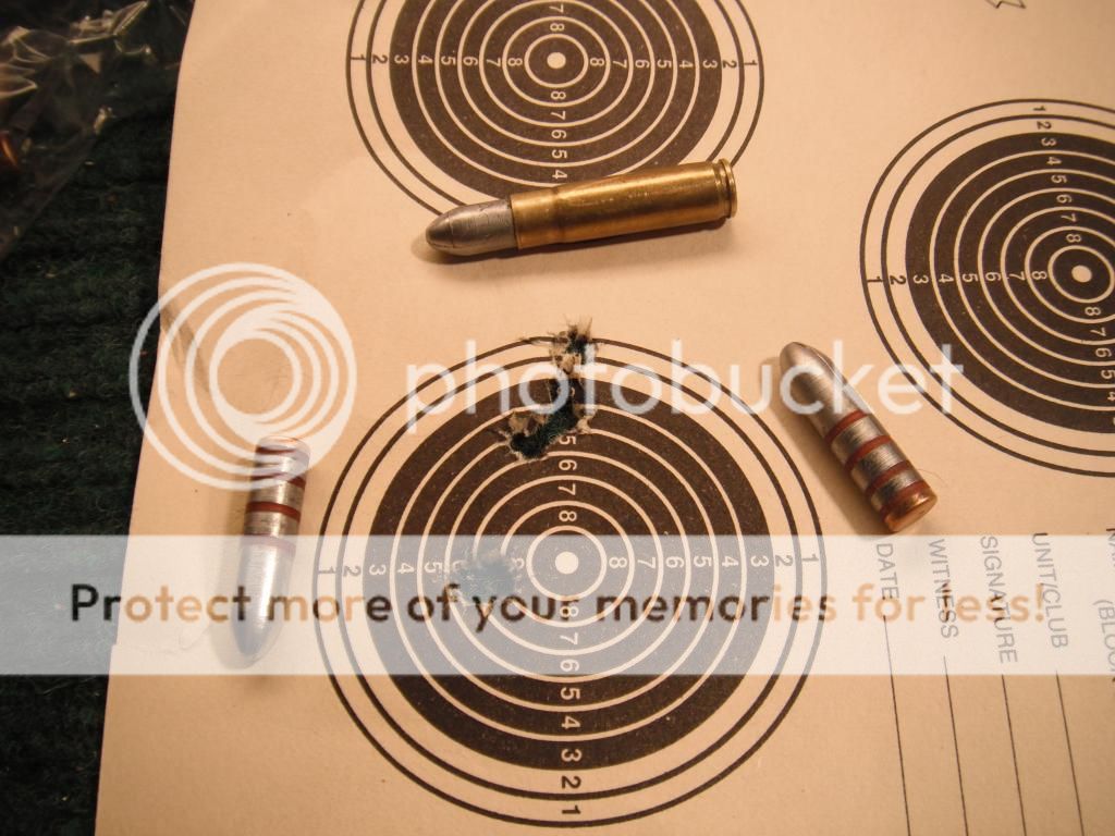

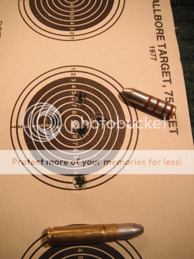

grouping was at 100 yards and were around 2 inches if was able to do my part and kept my finger from freezing up.
powder was H110 9.9 grains.
i did not have a chrony but this is not a subsonic load and did notice some flattened primers.
the bullet is a lyman 311284 and bullet weight is around 220grain 30 cal.
used it for this 300 blackout produced by north shore barrels, really great guy and great work.
the gun can probably shoot better if i do my part and don't freeze my fingers off.
only problem im having with this gun is that im not always getting reliable extraction out of the action for the spent case.
sometimes they just fall in the action but dont flip out of the action.
someone has mentioned this to me in the past with using a savage 223 donor action, does anyone know how to mend this?
