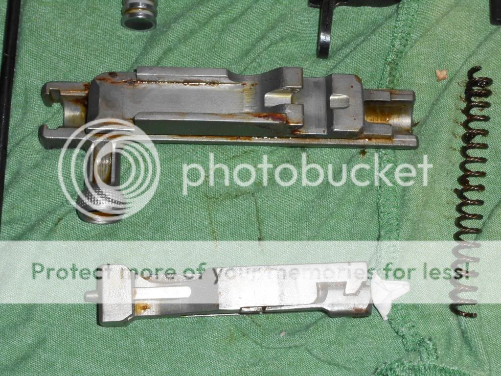

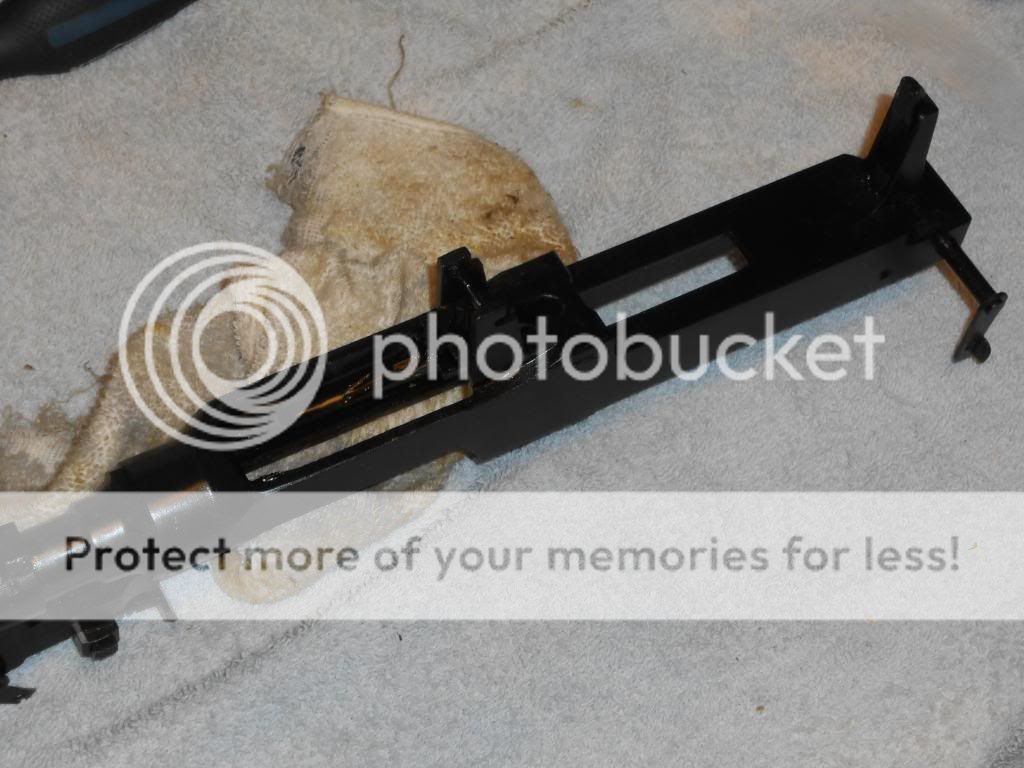

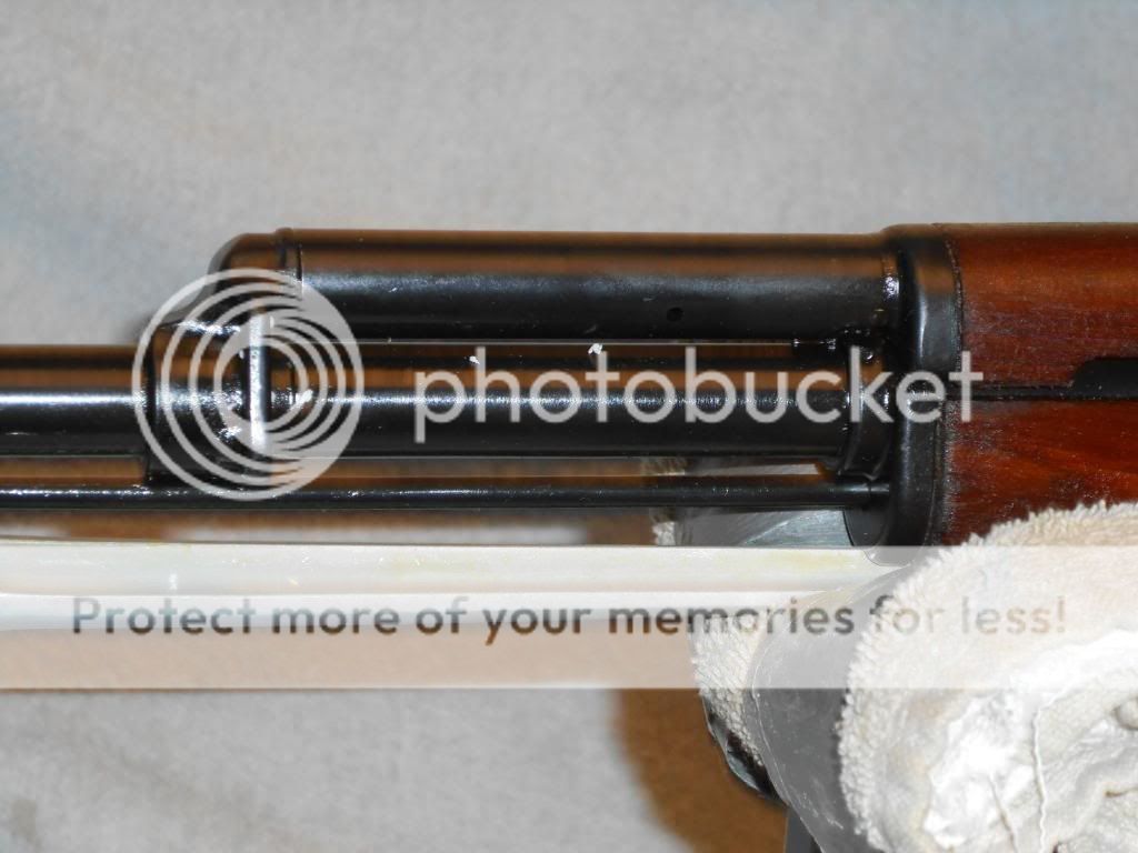

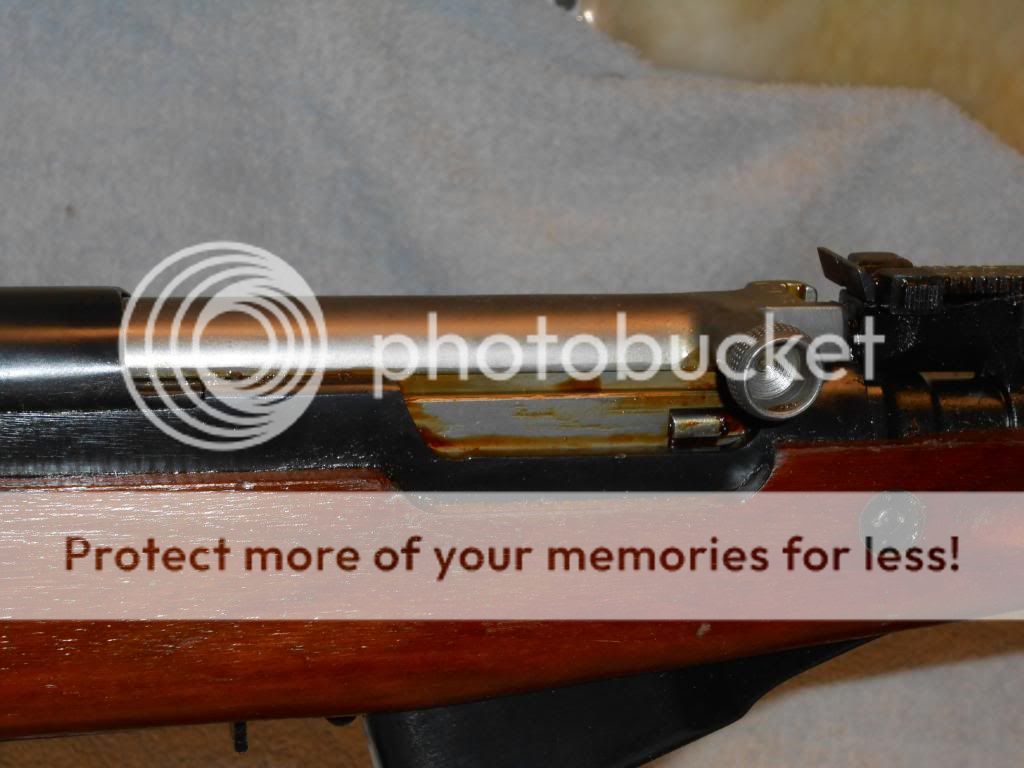

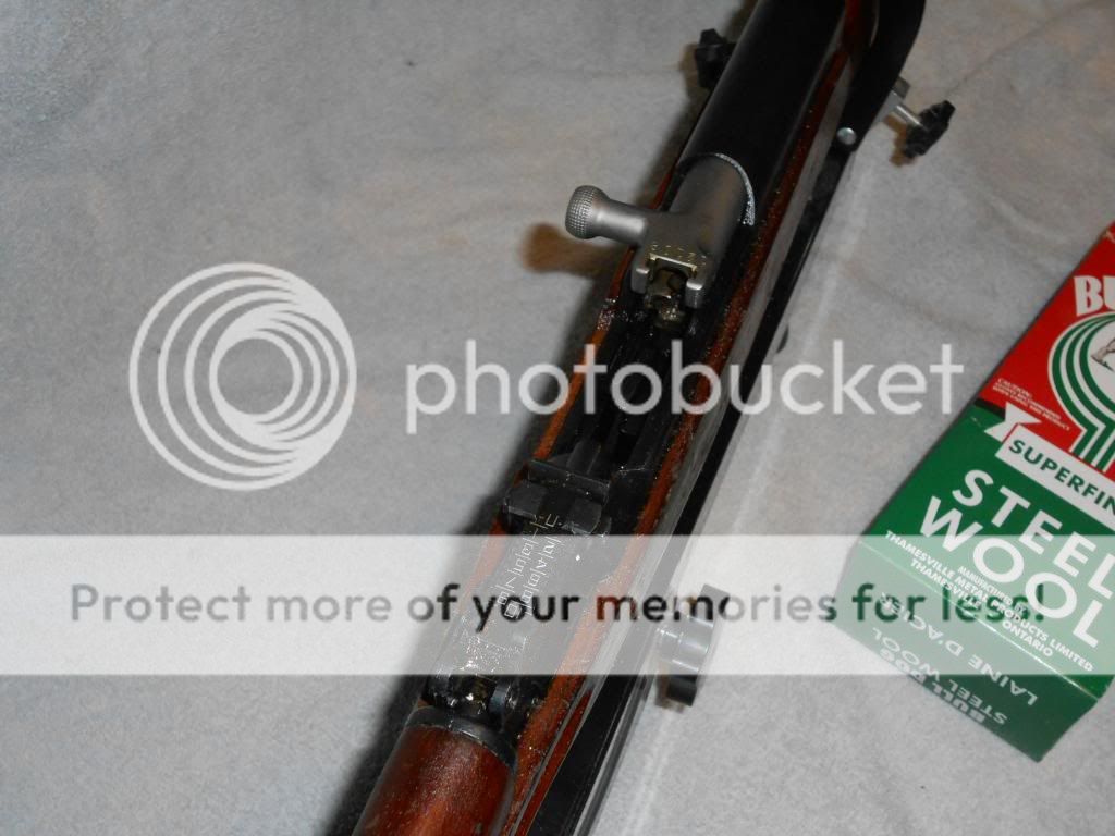

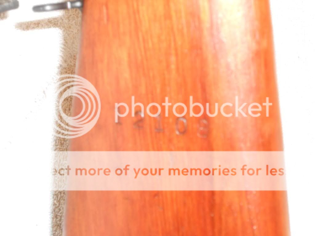

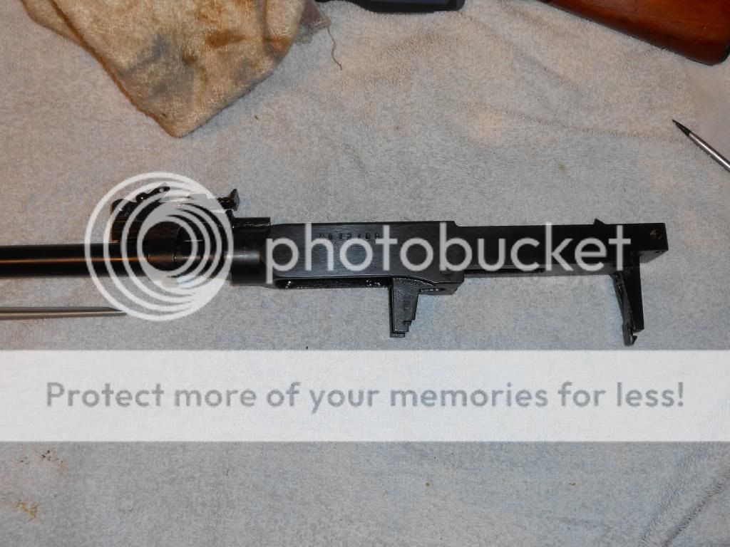

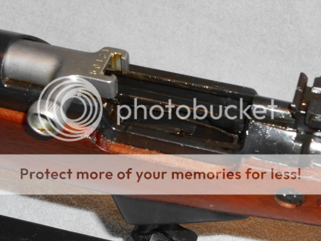

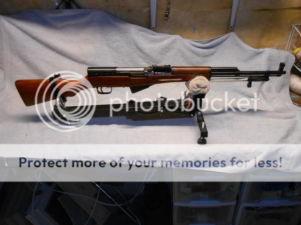

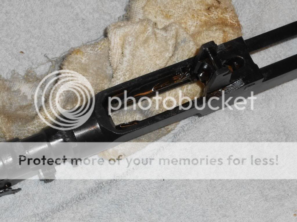

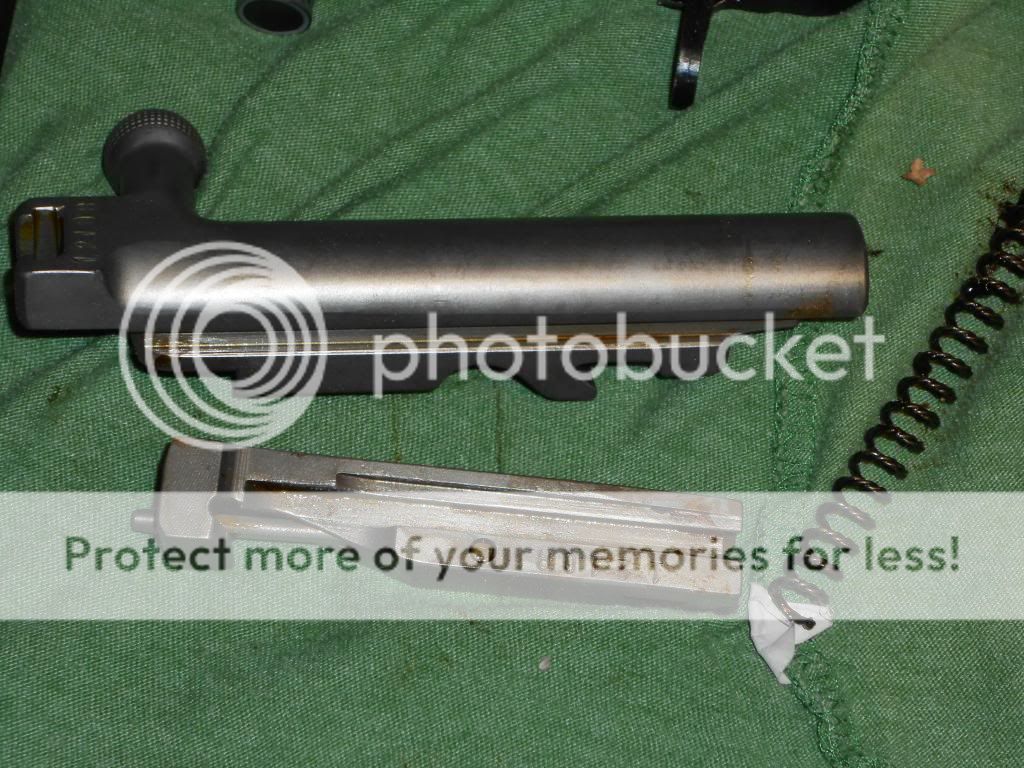

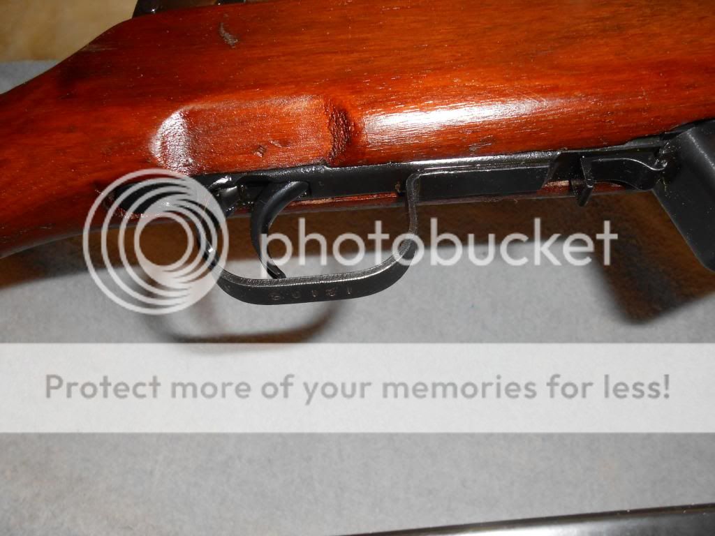

My new to me Chinese SKS arrived today, and I have been studying the markings to try to identify when and where it was manufactured, but I am a bit confused.
First of all, there are no Chinese markings of any kind on the rifle. In fact the only markings are the serial numbers, which are consistent throughout: 12108. The only exception to this was the hand written label on the end of the box: 0112108. To my eye, the stock was a bit rough, but the action did fit quite snugly into it.
Other identifying qualities:
-- short-lug threaded barrel
-- stamped trigger group
-- Cyrillic N on the rear sight
-- no lightening cut on the bolt carrier, bayonet lug, or anywhere else
-- shape of bolt carrier suggests mid-1960's construction
-- shape of socket at the back/underside of bolt carrier where spring fits in suggests mid-1960's construction
-- spike bayonet
So I throw this out to the folks that know more than me. Let me know what you think.
Here are some pics:
Thanks in advance!
Follow Up to My post Above:
-- Like Supernova, in his post just before mine, this one is from Canada Ammo
Thanks!
