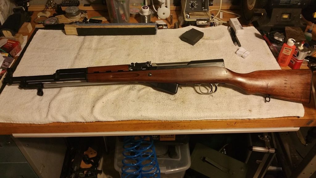

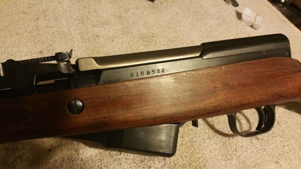

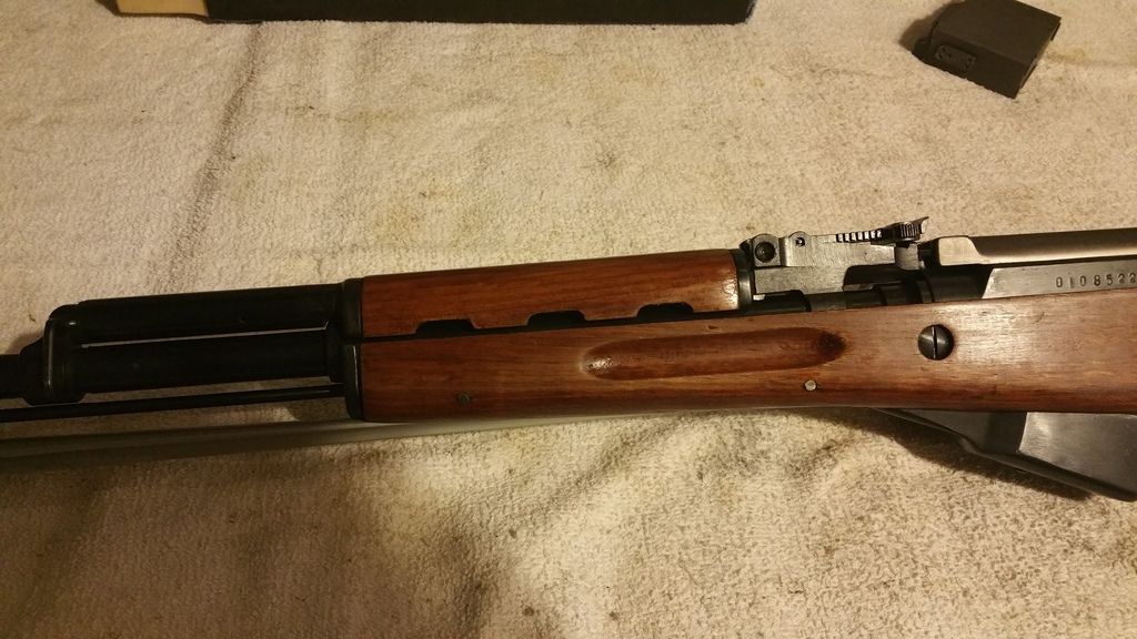

Thanks for the write up. I'm not 100% sure, but I think I have been able to narrow down the manufacture year of my newest Chinese SKS to being built between 1967 - 1970.
I made this estimation using the following guidelines found in this post:
Changes made in 1967.
-Gas tube, 1 piece 1956 - 1967, 2 pieces 1967 - 1980.
Changes made in other years.
-Top handguard, wood 1956 - 1970, bakelite 1979 - 1980.
Am I correct?
The only thing I am not sure about is the lack of factory code and other typical markings on the left side of the reciever. This rifle only has a 7 digit serial number which matches all other components on the gun.
The guns were scrubbed and new serial numbers applied. In your case that is a 2001 serial number. It is a military parts gun assembled for commercial sale. Most of these appear to be complete guns that were re-numbered before export from China.
People like to call them clandestine guns, but there is no evidence that they were made for clandestine operations outside of China.
You may be abe to narrow down a period the gun was made in, but an exact date is impossible on these "clandestine" commercial sales. Military version, rebranded for commercial export.
