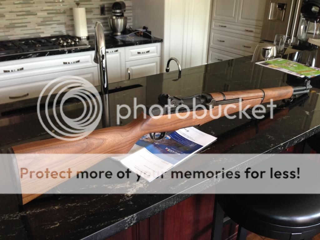

Looks like money well spent, serbinator, good choice!

Nice looking rifle.
