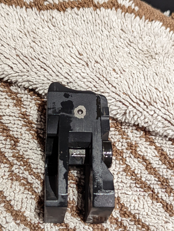

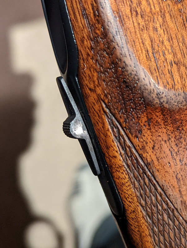

Scratching off the safety button with my nail.
The block face scrapes off easily.

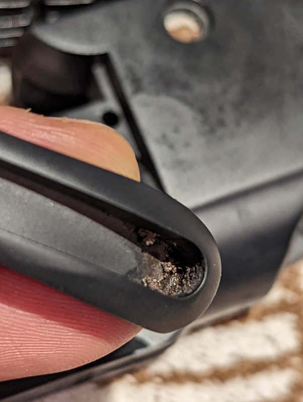

Nooks and crannies. The release to open felt gritty.

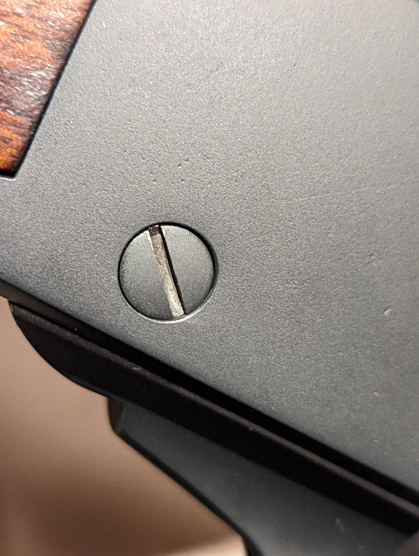

Screw holes where full of sand. Once I cleaned them out there is no coating in the slot.

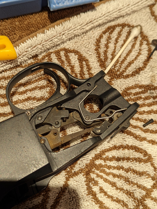

Internals seized
The trigger was literally seized in place. Had to take the whole thing apart and get the sand out of the springs.
Sand in the barrel.

Since the surface wasn’t prepped properly, it’ll need to be stripped and redone. You cannot trust where adhesion is good and where it isn’t, so the entire job needs to be redone.
If there's that much sand in the nooks and cranny's it means they did a poor job of blowing down the substrate before coating. That means the blasted surfaces will have dust in the profiling meaning poor adhesion to the primer.
If they were that sloppy I'd reckon they neglected to thinner wash the grease/oil off the internals before blasting which pounds the oil into the metal also causing poor adhesion.
