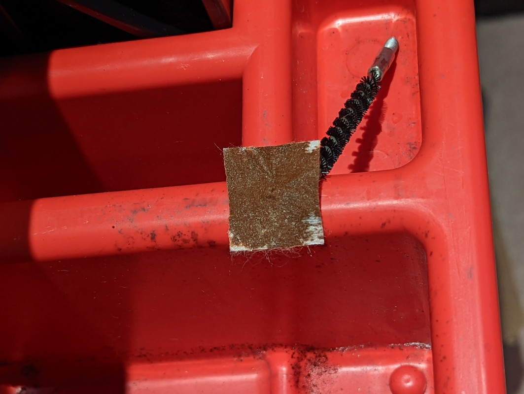

I've done several Cerakote jobs and there is several more issues than mentioned.
The internals looked like they were probably soaked in acetone then removed and not coated taking away any grease leading to the surface rust. If they were coated there would not be rust.They just coated the parts you can see.
they did not soak it long enough and gassed off the acetone it leads to poor adhesion on the breach block.
They coated the face of the breach block. It's almost as important to know what not to coat than what to coat when doing Cerakote. Hopefully they never baked with your springs and firing pin fitted.
Sand everywhere means they never blew the parts after soaking. Sand in your barrel is a good sign they never blanked of the barrel ends prior to sandblasting.
As for removing a crappy Cerakote job the only way is to re sand blast and start again.

I do both Cerakote and Gunkote .Cerakote has an aggressive marketing program but I prefer Gunkote it goes on much thinner than Cerakote and does not have the ceramic particles in the finish that make moving parts feel rough.Both products are 9PH hardness so if applied properly they are equal.Having said that it is evident that the prep on the Ruger was not good .That is obvious.Cerakote is fine on the exterior but because of the thicker application and the ceramic grit it can be problematic,you actually have to strain the larger pieces of grit out of the product before application.If you skip that step it is really gritty on moving parts.
This is clearly sloppy workmanship no matter what the product

A competent, first-time, hobbyist, wanna-be-gunsmith, could have done better work than this.
Anyone who does refinishing -as their primary source of income -should have done better prep work than this.
If you have a borescope, then check the barrel to see if they at least had the common sense to use plugs before sandblasting.
