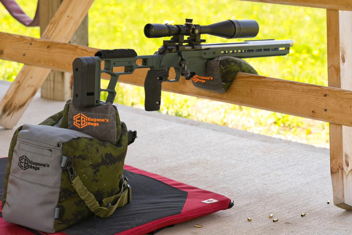

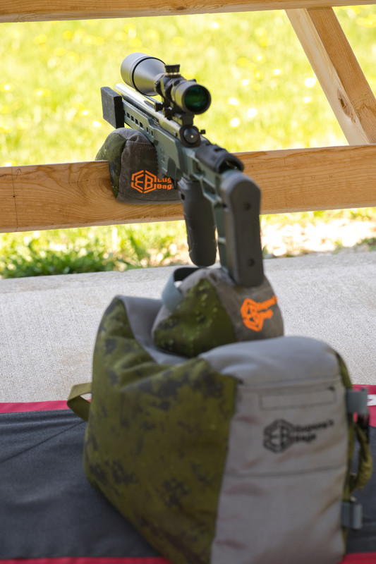

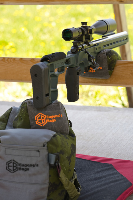

Match day was a blast, I had a ton of fun. I don't know what my score was yet, but I can tell you that I didn't win :p My custom bolt knob wasn't an issue like I was concerned it might be, it ran just fine. Build wise, zero issues chambering, extracting and ejecting, flawless performance. Goes to show concerns about tight chambers in repeaters may be slightly overblown, or speaks to my smithin' skills, you decide. I'm certainly feeling a certain satisfaction that not many can relate to. I didn't just bolt some components together and call it a rifle, I made steel chips fly and crafted this rifle to the fullest extent myself.
I added all 4 fore end weights and found that still didn't move the balance point far enough forward, weights close to the receiver have little effect on the balance. I did a quick and dirty external weight with a chunk of steel I had lying around, that made the balance good enough. Add it to my ever expanding machining project list to make the weight pretty at some point, but it's not a priority job. I might cut it in half so the two external weights can be mounted on either side of the stock right at the end of the fore stock for maximum balance effect, that'd be done when I get to making it pretty. Works for now so other jobs take precedence.

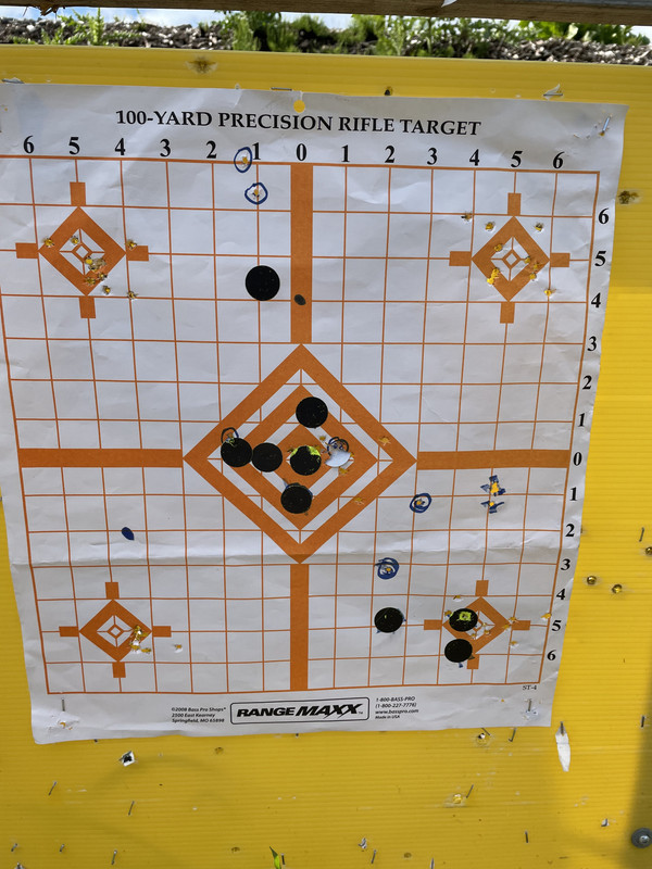

Couple ORPS matches to attend this month, one tomorrow, another in a couple weeks. I got out to the range today for some practice and to refine my scope settings. Last match I only had a 50y and 100y zero, since I was last at the range before registering for that match, this hurt my scores trying to guess holdovers at 25y and 75y stages. I put the Sightron SII 6-24x scope on since it can actually focus at 25y unlike the SIII. I had the time to test some ammo at 100y, gusty wind today so the horizontal from that shows up in the groups. I didn't shoot any expensive ammo, just the economical grades. Acceptable performance from 3/4 types, SK Semi-Auto confirmed to suck in this rifle. I was also getting my 64 w/IBI barrel sighted in with a new-to-me Leupold silhouette scope and was testing naked barrel to see what ammo I could use for silhouette. In my 64 rifle, the SK Semi-Auto meets the performance needs for me in silhouette, and the SK HV Match sucked. The opposite of my PRS CZ.

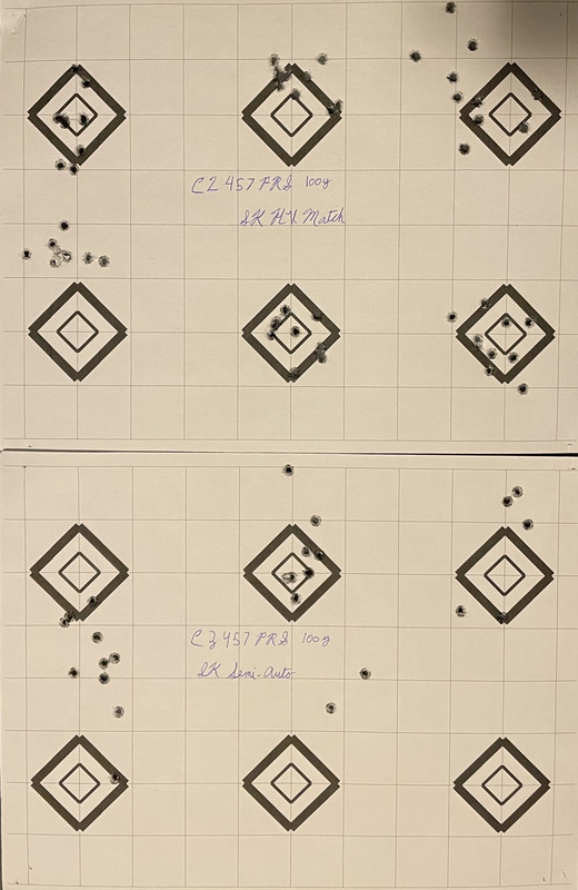

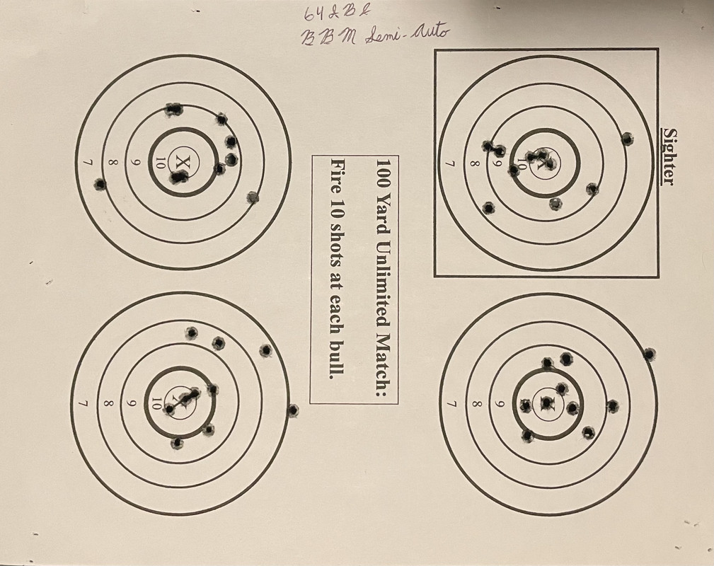

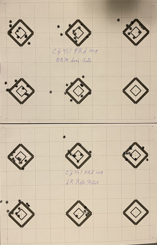

While this isn't a 5 year long peer reviewed study with 5000 groups shot to determine the exact difference in group averages to the 0.0000000001% between the two rifles with these ammo options, the testing is sufficient to determine there is indeed a significant difference in ammo performance from one rifle to the next with these two varieties of SK. I'm not naming anyone specific, since there are people on other forums who are not members here that promulgate such narratives, but the assertion that a good barrel simply needs good ammo to produce good results is untenable and so full of holes that it only stays afloat by the immense amount of hot air blown into it to displace the surge of water sinking it. Naturally, one cannot expect low quality cartridges to produce good results aside from the occasional random act of accuracy, garbage in, garbage out, after all. Quality cartridges are a prerequisite for good results, this goes without saying. One must then find the correct pairing of said quality ammo with their individual barrel for good results to be forthcoming. Should the ammo not suit the barrel, the results WILL be poor, the quality of the cartridges notwithstanding. This isn't even debatable. It is the fact of .22LR rifle shooting. Anyone is welcome to attempt to prove me wrong on this, but be forewarned, you will only prove me correct in your pursuit of doing so.
My CZ had up to 4.5" of vertical with the SK Semi-Auto, while the 64 was much tighter. I'm seeing that the barrel on my CZ is quite sensitive, I'm definitely going to have to work on mitigating the barrel vibrations. Perhaps I could attempt shimming the barrel at the end of the forestock with a pressure pad as an interim solution until I come up with a muzzle device for it. I purchased a nice set of bags, after today's practice session the pump pillow is huge plus IMO and I look forward to an improvement over my previous match score, which was around 300. They gave me a 0 on one stage for some reason, even though I did 60-70% hits there. No matter, I'd only have been middle of the pack with my actual score. I did some other "shooting" while at the range, please enjoy some rifle pR0n.

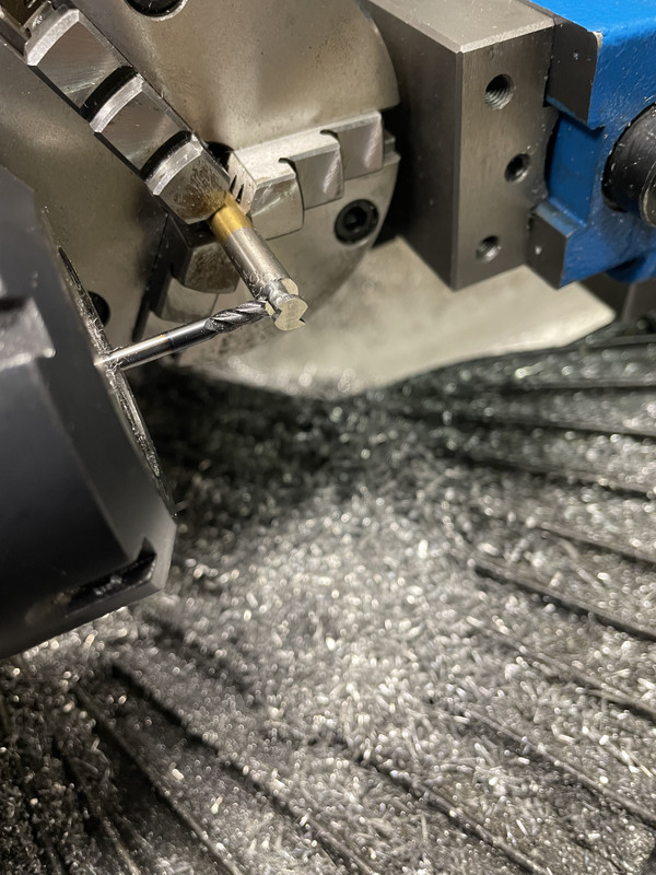

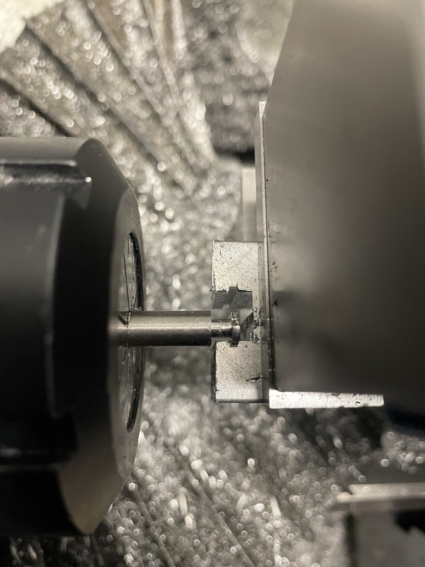

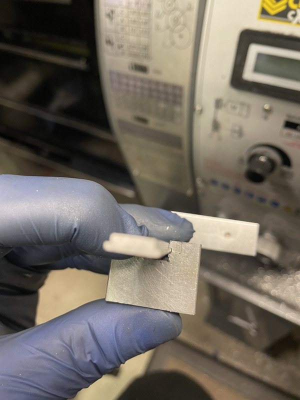

I've got most of the work done on my external weight set, I just need to make an internal grooving cutter to make a quick detach swivel stud hole and then do the surface finishing work so that the weights look good too. To make the special tool, I'm now building an upgraded tool rest for my bench grinder. I need to slot the platen for a mitre gauge, good luck finding a T-slot cutter of the required dimensions. So, I made one! Drill bits and taps tend to break over the course of one's machining career, but rather than throw them out, the savvy machinist saves them. They're good tool steel, after all. They can be recycled into specialty cutters for one-off jobs where a purchase is either not possible or financially practical. With a carbide end-mill I machined the cutter to the required dimensions.
Did a quick test in a piece of scrap, the cutter cuts well.
The slots cut are perfect for the mitre gauge, success! :D

Some pleasing results with a few of the ammo types, R-100 delivered 3 sub 1-inch groups, something that I think in another thread very few rifles without a tuner have posted such a result. Competitive accuracy is readily forthcoming from the higher grades of ammo. Rifle Match "S" was not so good though.
I picked up a case of RWS Target Rifle for practice ammo, looking good for that, it's almost good enough to use in competition. Rifle Match wasn't doing too hot and with the misfires being very difficult to remove from the chamber, I stopped after a fouler group and 1 score group. I had to shove a rod down the barrel from the muzzle and nearly hammer out those rounds, I was not comfortable with that. To finish the target I shot a 5-round group of Target Rifle and a 10-round group of Rifle Match "S", which had a blade of grass in front of the paper so created some fun splatter.
The Lapua Long range is certainly an improvement over the SK HV Match. I note a tendency for some fliers which tells me this ammo isn't likely to do anything impressive for benchrest shooting, so I'll use up the rest of this brick at the next few matches. Then I will transition to RWS ammo. I've got one brick of R-100 and 6 bricks of Special match composed of 3 different lots. Of course I cannot get any more of that R-100 now. I'll see how I progress and if it's worth using the R-100 later in the year, Special Match will be good once I finish the Lapua.
