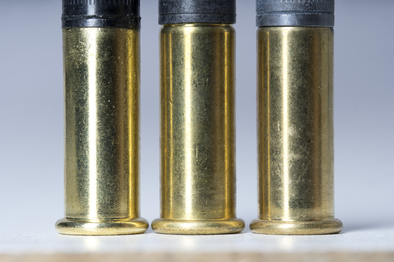

Thanks. No I don't use an app, I like hard data. Since I've been having matches on very windy days lately, it might be worthwhile to look into something for wind adjustments, I know I am weak on wind management at distance (100y+). I wouldn't say I'm obsessing over best ammo, I've only done some casual testing so far. Did I shoot any Tenex, Midas+ or R-50?
Look at how I assessed things, SK HV wasn't shooting anywhere near as good as I initially thought, Lapua LR showed me it's not worth using for benchrest shooting thus giving it a use case in this rifle for ORPS. R-100 looked a little too good to use, for one me not (yet) being able to take full advantage of it and I'm torn on saving it for benchrest shooting. Center-x (not tested) runs what, $22.50 a box these days? R-100 about the same. RWS Special Match I got as low as $16/box, and it's hitting that sweet spot of price/performance, much less likely to have nasty surprises in it like the SK has or the lower grades, orange and yellow box RWS. I've had Center-x that shoots poorly before so the current price of it is uninspiring compared to what I'm seeing with RWS Special Match. I prefer to get reliable feedback knowing that my equipment is putting shots where I send them. Misses are me, I don't have to scratch my head and wonder what's going on with the gear.

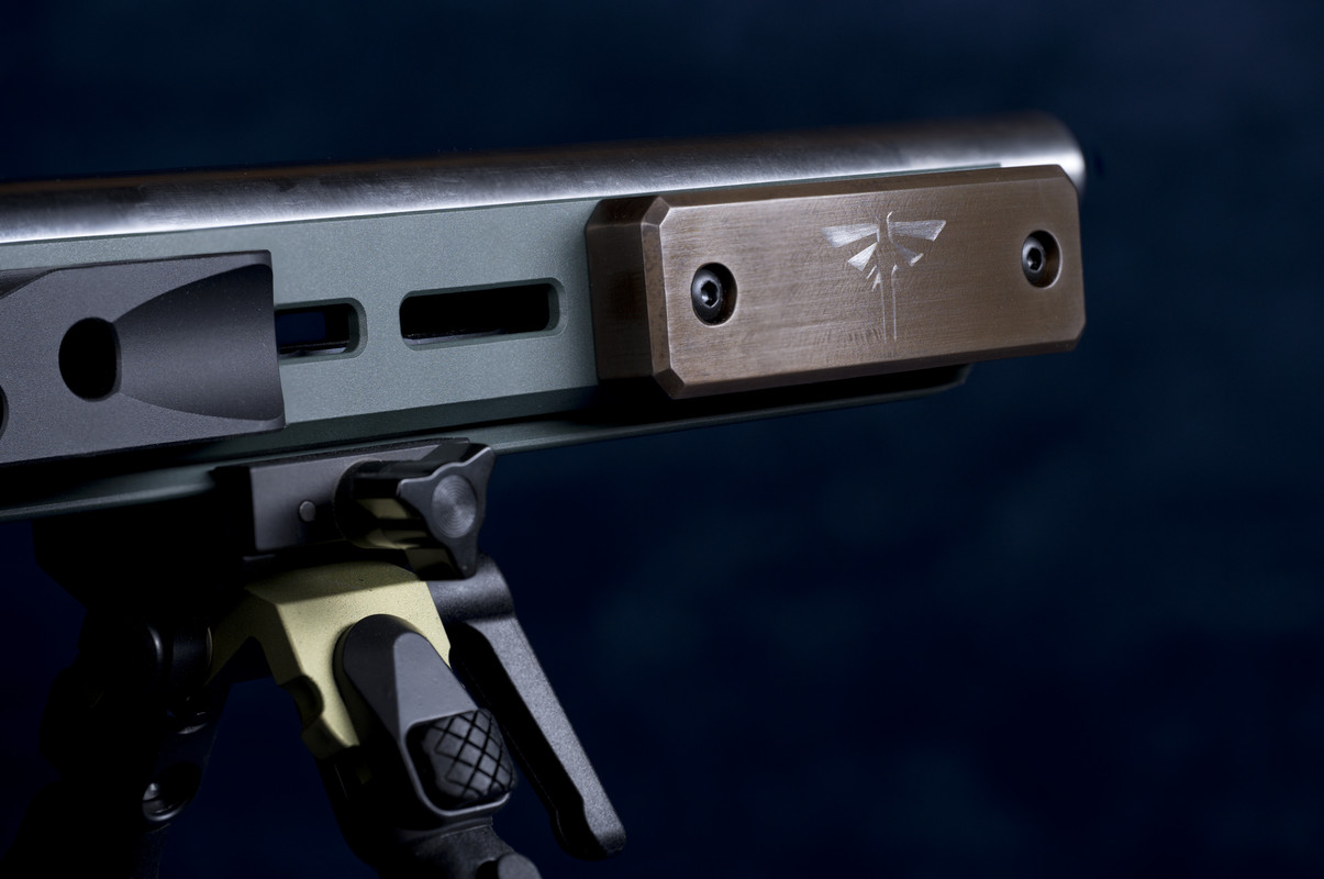

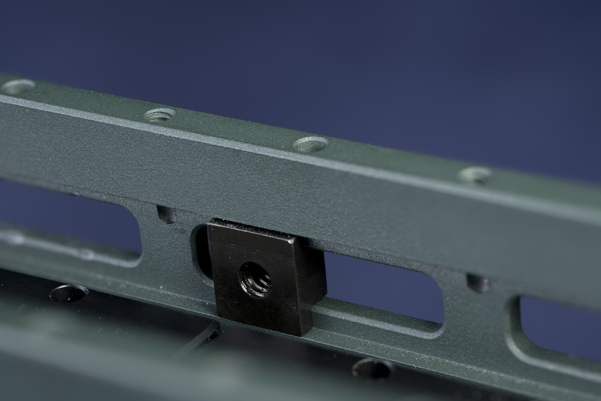

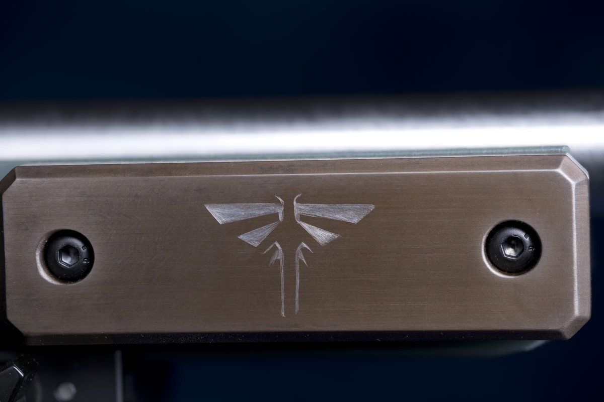

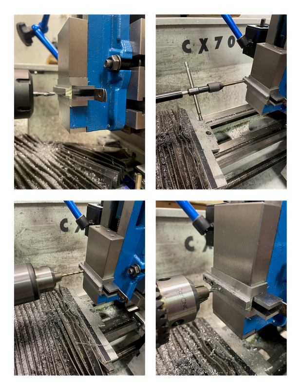

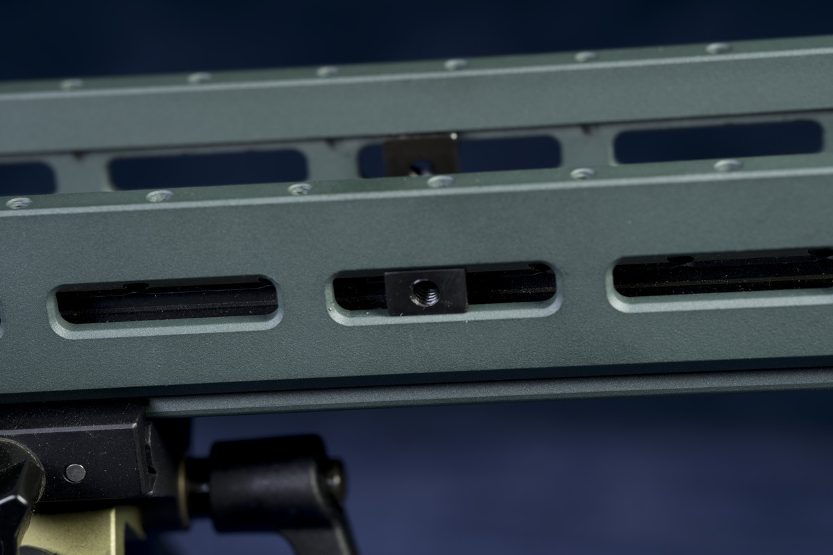

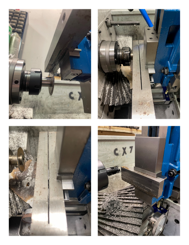

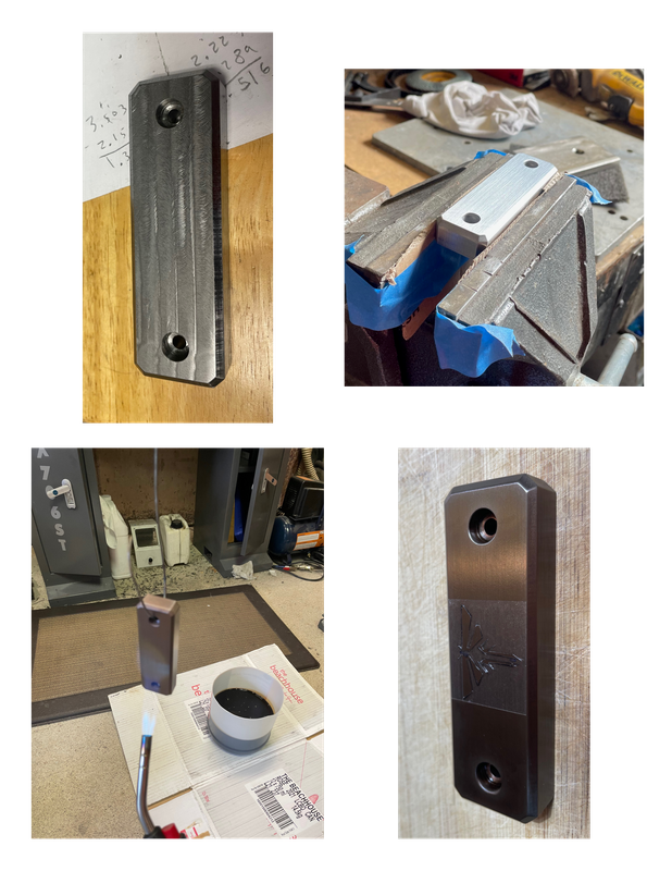

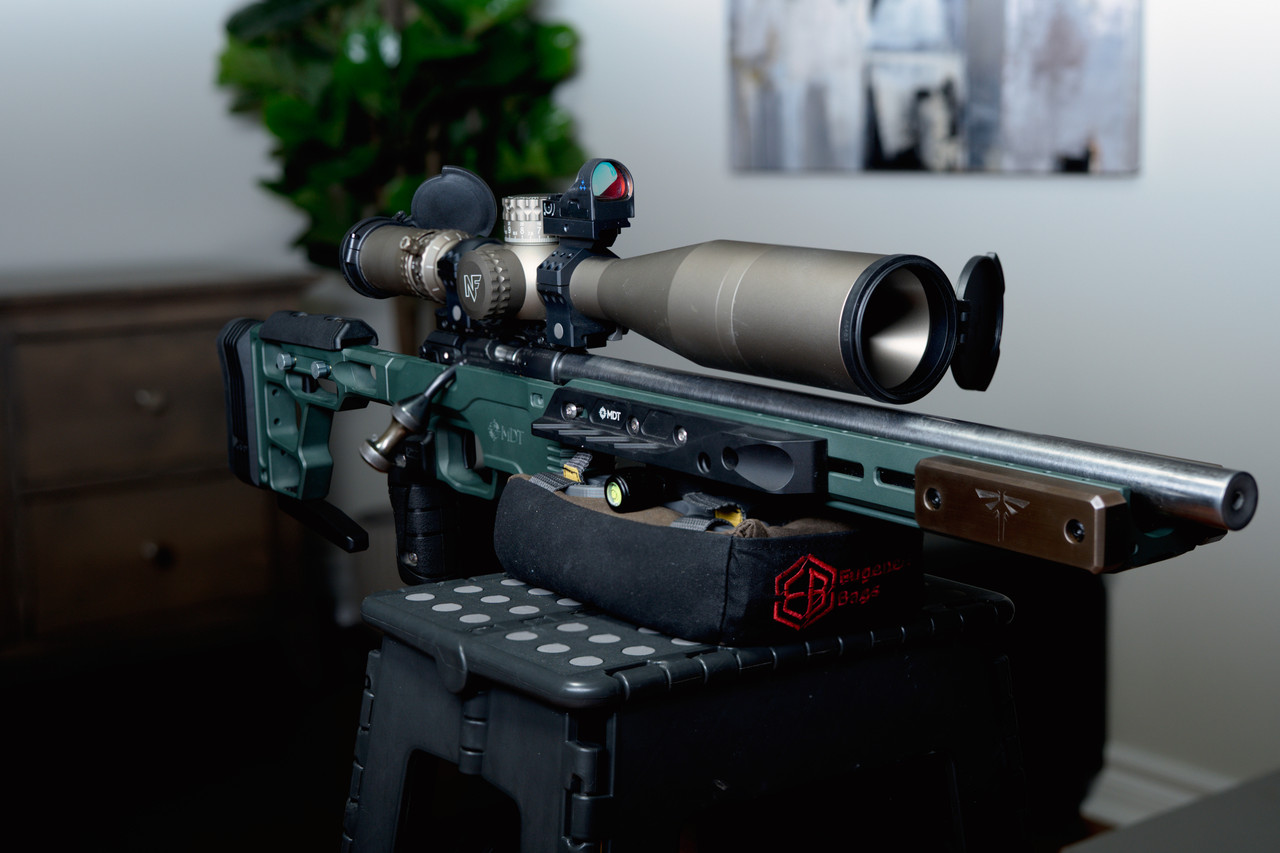

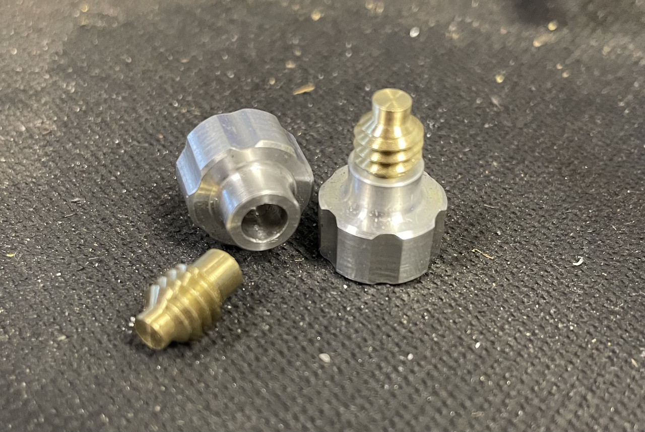

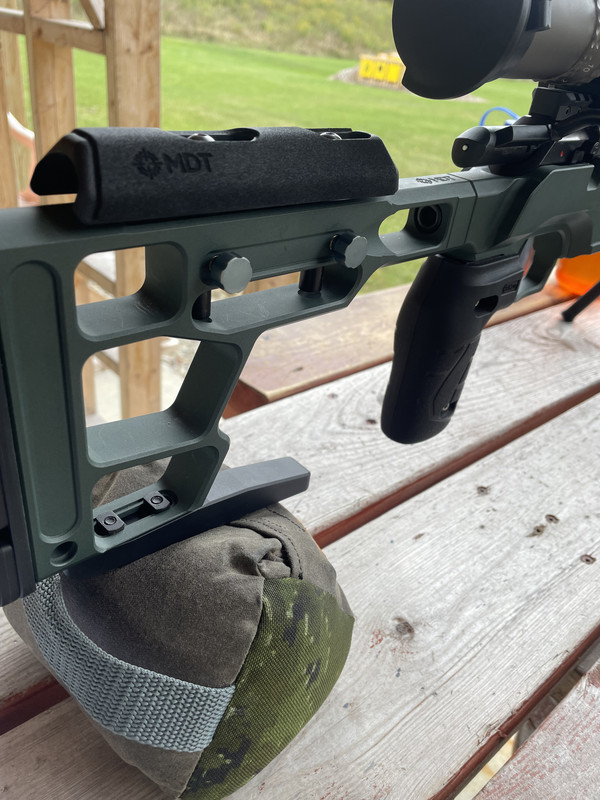

Speaking of the gear, I feel pretty settled into a final setup and all the accessories I'll need for some time. From here on in, nothing major will change so I will start building that necessary familiarity with everything. I'll talk about some of the things I did to get to the final setup. A pair of exterior weights was needed to get the balance where it needs to be, the full set of internal weights was not enough. I got by with a quick and dirty weight while I worked on this. First I made some T-nuts. Yeah, I could just buy some M-lok nuts, but where's the fun in that? T-nuts are a basic machinist's project and good practice. I had to shim the parallels to give the cutter a C-hair of clearance from the vice jaws. Clearance is clearance. Straightforward stuff, move to coordinate, centre drill, drill, tap, chamfer. If my machine had a DRO I'd do all the holes with one tool rather than changing tools for each hole before moving to the next, but with analog it's easier for me to just finish one hole 100% before moving coordinates.

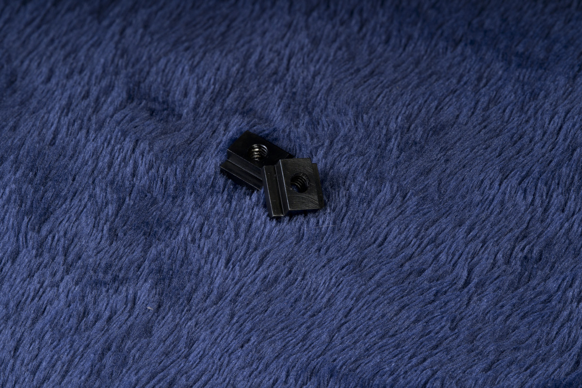

With them all done it's time to slice my nuts off.
Git yer mind outta da gutter! Not
those nuts, jeez!
Gave them a cold blue treatment
There's something so satisfying about a precision fit

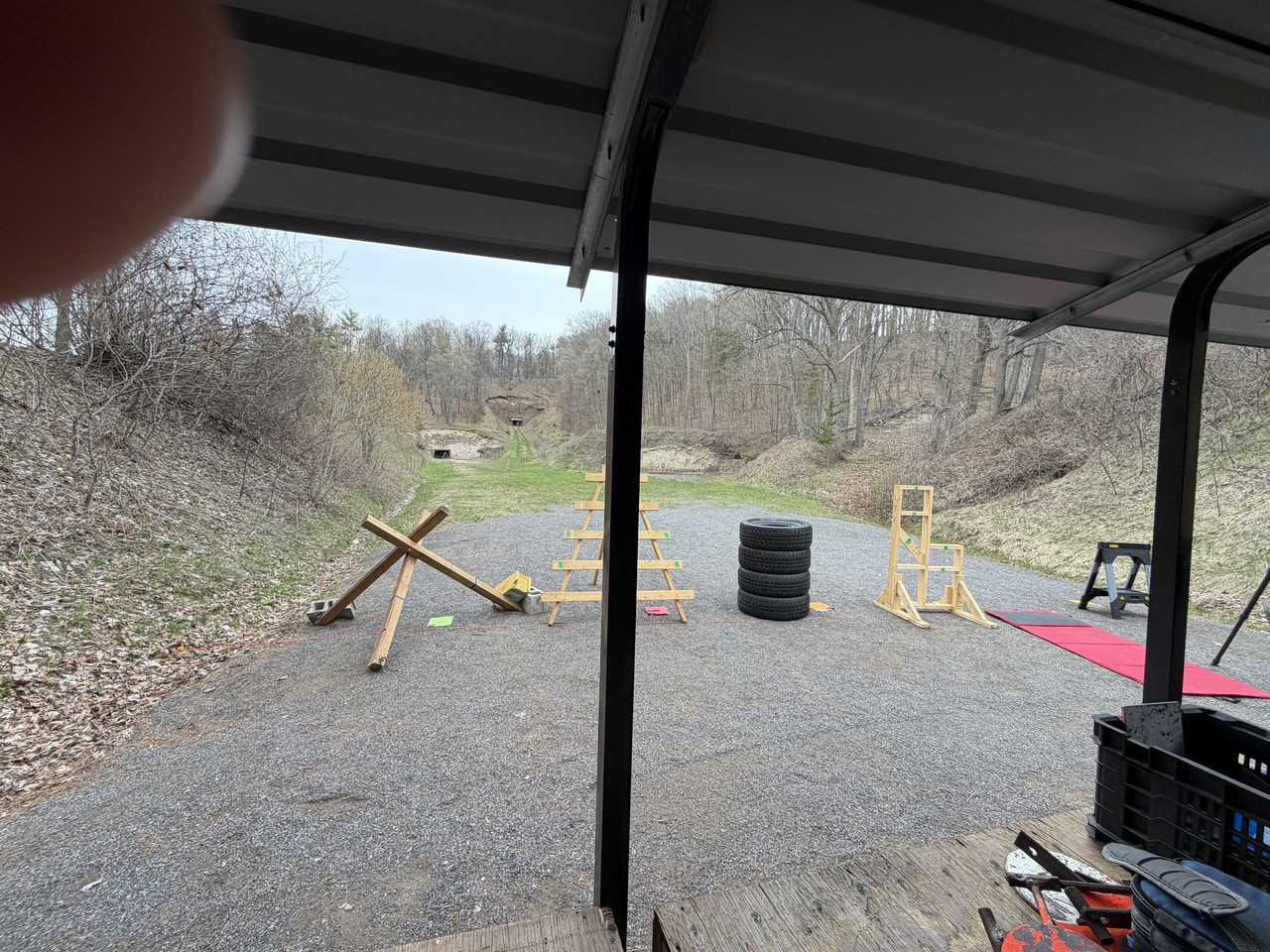

Pile of tires next, I did a little better, 9/12 = 75%. Now the nerves were settling and this was just a challenging stage, tires are bouncy and it's difficult to stabilize on them. Next stage, 5/9 = 55.5%. I don't know, I had a bad stage, it happens. To finish, I cleaned the tank trap, 100%. Always satisfying to finish strong. Overall, 79.55%. Now I'm at a point where my rifle is setup the way I want it, and performing the way I want it, so I'm getting a good read on the things that I need to work on for my shooting. I had a good run up the learning curve and have hit that point where gains will be incremental and commensurate with the amount of practice I put into it. I know I have it in me to perform at a high level, I just need to put in the work to get there. I'd like to take a spot on the podium before the season is out, don't care if it's 1st, 2nd, or 3rd, I know competition is stiff at the top of the leaderboard. It's good to have goals, even if you don't meet them, in trying you will improve upon where you currently are at, and that's what really matters.
