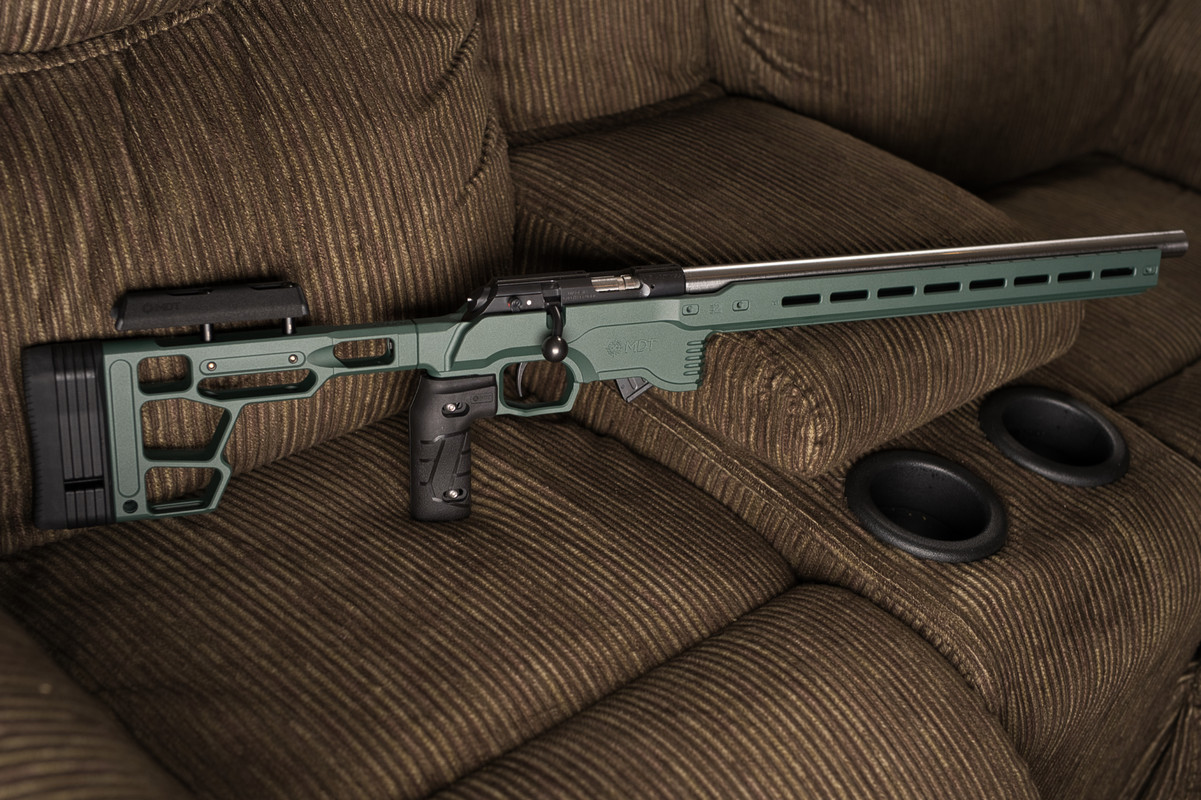

I got out to the range today, not a bad day, got up to +10C. Was overcast and foggy/misty, target papers got moist. Good things first. Function wise, everything is good with the build. I've seen some express concerns that repeaters will have an issue feeding into a tight match chamber, so that's why they usually have looser chambers than true single shot bench guns. While I did most of my shooting with a single shot adapter, I also spent some time ringing steel using 10-round mags. I had no feeding issues despite the tight benchrest style chamber. I did give the chamber mouth a slight chamfer, rather than having it as a sharp 90 degree edge. Feeding the wadcutter Eley bullets from a magazine might yet be an issue, but anything standard round nose should work fine. Extraction and ejection was good, able to pull live rounds and only one or two spent casings didn't eject properly over the whole day. I had a lot of ejection issues before when I was shooting with the factory barrel. I did some light stoning of the claws and it seems to have done the trick.
Results wise, I didn't come away with anything I'd brag about. I shot mostly new-to-me ammo ordered this year, and am unsure of it's quality. I came back to the first target and shot the bottom row of RWS Target Rifle again after getting up to a higher round count, to see if some degree of "break in" would make a difference. Not sure, other than I suspect this RWS Target rifle is just crappy ammo. It shot all the ammo here like what I'd expect a factory MTR to do, with a few bad groups.
Onto some higher grade ammo, a row of the new stuff followed by a row of the old stuff. Other than a few fliers, the old Special Match shot like what I'd expect out of it, while the old R-50 did not shoot as well as it should. Also shot the bottom row with Rifle Match again at the higher round count, maybe better than the first run with it? Rifle Match was giving me a number of fail to fire, recock and hit again would fire though. Only ammo that happened with. Fliers are ruining my day. See how many groups have 4 rounds packed tight and then a stupid flier... Some really nice groups here though, 5/25 in the 0.2's is more than just a random act of accuracy.
I had been cleaning every 50 rounds, at this point I thought I'd see what'd happen if I went up to 75 rounds with the Center-X. This ammo hasn't impressed me out of any rifle of mine to date, I'd long ago written it off as a bad lot. Some really nice groups with it... but those fliers again. I shot one group with 10 rounds, not intentional but I kinda zoned out... so my round count is off by -5. I'm only counting "for score" shots, not foulers, so exact round count isn't there anyway. SK High Velocity Match looks like it might be serviceable for PRS, hope so since I bought a case of it :p SK Semi auto.. ooof, crappy ammo. That or this rifle really doesn't like it, a lot of vertical. If I get a tuner working on this barrel it might be worth revisiting.
Now that we're getting into winter, the weather isn't really conducive to serious accuracy testing for the next few months. I haven't run any Eley through it since their wax gets real stiff in the cold. What I think I'll do is take the SK HV out to 100 yards and see how it does, then focus on finishing the build setup for PRS. I'll need to get some fore end weights to balance it and rings for the scope I intend to use. I'd also like to make a custom bolt knob for it. Looking over the results today, they're somewhat demonstrative of what a rigid barrel does, not a drastic difference from one ammo to the next, though nothing really stood out as exceptional. That's what gets me, usually when I run through a selection of ammo like that, something does well. Has ammo quality lately declined so much that rather than hoping for a good lot, we're hoping to get something that can do a 1/2" challenge? I'll need to do a sanity test and run the ammo through a known good performing rifle for comparison. Tuner wise, the short stiff barrel doesn't suit commercially available tuners. Calfee has said that a standard Harrells is bordering on too heavy for a 24" 0.900 barrel, with mine at 17.5" I can't see it working well. What I could try is removing the rotating half of a Harrells, and machining a little aluminum ring for it in it's place. That could lighten it up enough to work with my barrel, and still be adjustable.
Yeah so test the SK at 100, finish the setup/build, and basically just practice banging steel until I've got a couple more bricks through it before I revisit accuracy testing. Test my ammo with my good rifle so I know whether or not those fliers are just the ammo or there's some issue with this build. My good rifle took a few thousand rounds to settle down and really start showing it's stuff, we'll see what happens with this build over time. I also got a case of that SK Semi Auto, I can have some fun with it banging steel to get the round count up without burning the "good stuff". It's a nice rifle to shoot, I never mentioned I also put a Timney trigger on it. Good trigger, nice and crisp.
