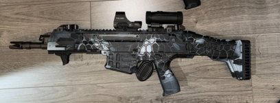

What worked for me is 1.70”. I use a Badger Ordnance mount and a Vortex Razor 1-6 and I found this height works with me with the waffle stock.
I had originally used a Burris PEPR with the same LPVO which if I remember correctly was 1.54” ish height. That was too low and I was getting scope shadow.

thank you for that. I did notice in the photo you have the BR/ ACR stock and not waffle. Still same same in regards to height?
was
Ahh ok my bad I’ve been calling it the waffle stock, thought that’s what it was thanks for informing me it’s not.
I haven’t swapped stocks at all, that’s the stock that works for me with the 1.70” mount.

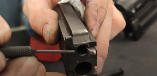

Gonna put here for reference.
Wear after 7k (probably a bit more) of select auto Bren 2 in Ukraine. 10% was full auto. Operator is SOF, so while not a trench warfare, but still real combat use, including submerging to water, not cleaning for up to two weeks. Operator's test show that 1.5k rounds uncleaned becomes non-reliable so recommends not to go over 1k.
Firing pin safety. Insignificant.
Plastic link of charging handle.
Aluminum rails rode by steel carrier. Not bad, I expected much worse.
Gas port. Not great, not terrible. Fair for 7k-10k.
Crown:
Bore is OK (factory guaranteed barrel life is 20k):
This hinge is survived, but it's a miracle. Many are broken. Note how it bends under pressure.
In all fairness those plastic stock hinged lock ups are not the most sturdy. When G36 first got issued back in 1997, there was a picture floating around of a broken G36 stock from a German jumper.
And the Bren hinge lock uip is essentially a HK G36 design.
Yeah, I saw quite few pics of broken hinges from my sources in Ukraine. Well, they acknowledged and changed it in Gen 3. Not a big deal for sport shooter though.
