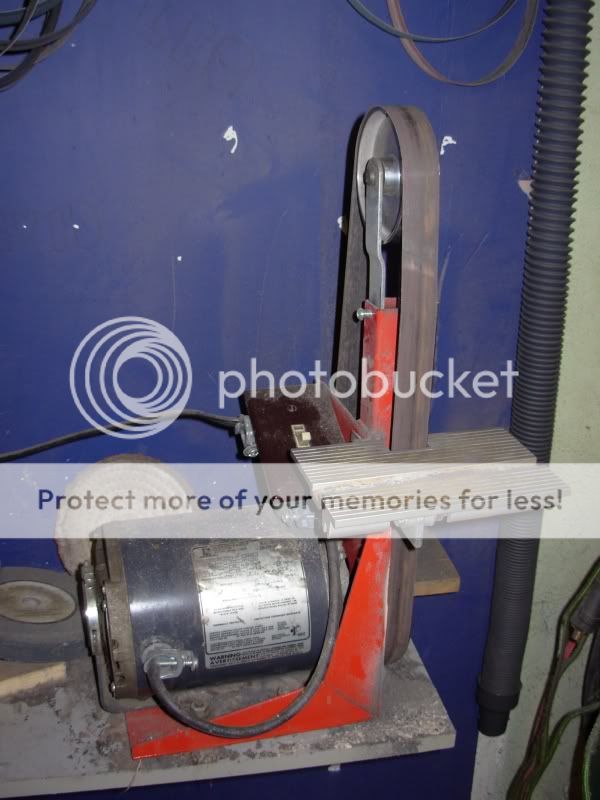

I used a belt grinder to do almost all of my shaping (trigger bar, locking block, hammer, sear...) It is easily my most used tool for metal working and has paid for its self many times over. I got it from Lee Valley, I think it was around $90. You have to supply a motor to drive it but being in the HVAC industry I had plenty of old 1/2HP blower motors kicking around...
With a 60 grit belt it files through metal like crazy, with a 5 micron belt it will polish an blade to a razor... I wonder If I could fit a 1hp motor in there...
Anyway, I just ensured my table was square and went at the back side of the hammer with a 220 grit belt. I think it took all of 3 minutes. If only I could fit it in the mag well to get rid of the ribs...

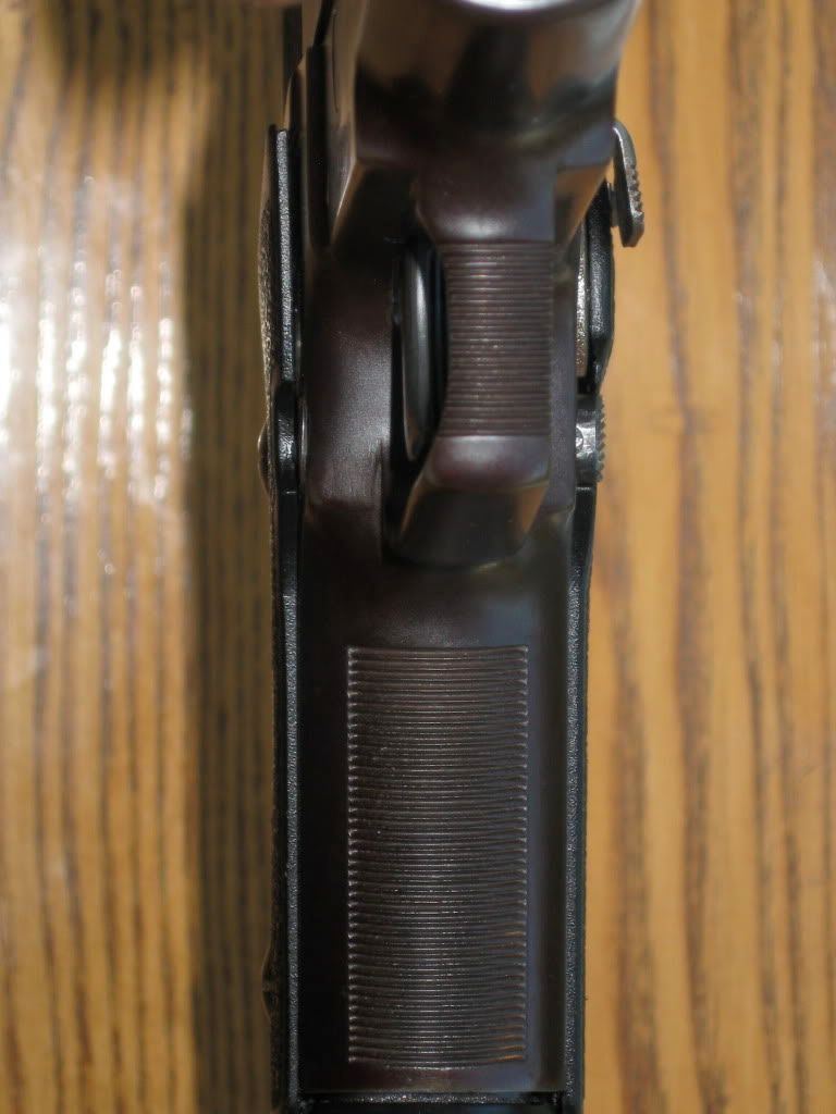

I think that it would take a great deal of preparation to bring it to a level of shine suitable for plating . Mine looked like chrome before bluing, yet the bluing brings out imperfections. I did a hot - rust job on the frame, which was a great new experience - it is obviously very durable. I blued the slide - but I may hot-rust it also after test-firing. The internals all seem to work well - no majour issues in fitting.
This has been a fun project - a challenge for sure.

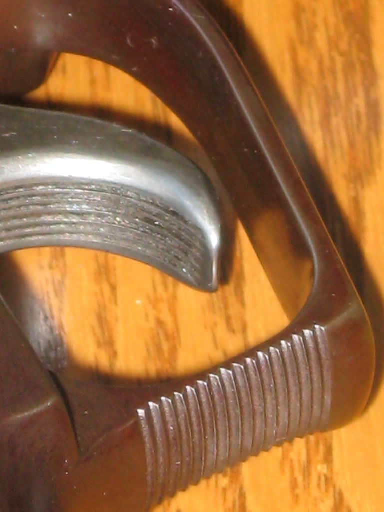

I opened the trigger guard up to give better ( faster ) access to the trigger. I may find a place to put an adjustable trigger stop also - to keep the trigger back further - again, to give better access to the trigger.
I also opened the guard up at the rear - a little more than I needed to. Next time, I may open it up on top - I notice that my trigger finger is held down a little too much - making the finger just a little uncomfortable.
I really did not like the bite on my trigger finger from the corners of the tip of the trigger. A little careful work - rounding the tip of the trigger fixed that problem completely.
I put a lighter spring in the mag release - it was unnecessarily stiff. A little work made the mag pop out easily.
After test-firing, I will put a lighter hammer spring in, and lengthen the trigger pull to the rear, and maybe a little to the front, giving a long light pull.
A little work with a tiny file cleaned up the grooves in the frame - getting rid of the casting line down the center. The gun is not as red as the pictures appear.

Thanks - It is a rust process which uses heat to accelerate it.
It is certainly not for the faint of heart - it made my heart faint to see all my shiny work turn to rust in seconds.
Midway through the job, it looks like it has been left in the rain, with no oil on it for two weeks.
It is, it seems, more durable than anything that I have seen, though not as shiny. Well okay - stainless is durable too.
The pictures show more red than they should.

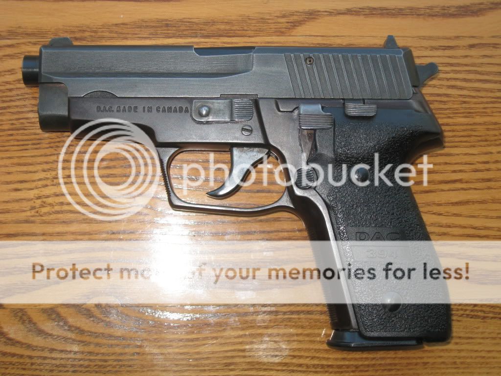

Well boys time to stick a fork in it, cause I think its done !!! :D
I applied the Cerakote tonight ...... graphite black on the frame and stainless on the slide. The only thing left to do is another range run to see if I've improved the light primer strikes ...... I've reshaped the firing pin, done the MiltonBradly modification to my hammer strut, and I even took a couple of coils off the firing pin spring. Hopefully I'll see some results.
Well, its late ..... I'll think I'll toast her with a beer, then off to bed. Oh yeah, here's a couple of pics of her in her party dress !!

I forgot to mention that I changed out my firing pin spring to a lighter one (misc spring from a Princess auto grab bag) to maximize the strike. I have also swapped my hammer spring to an Ed Brown 19lb 1911 hammer spring (I have a pack of five but only two 1911's) and that has dramatically dropped the DA pull. It will touch off WSMP primers in both modes (only SP I have at the moment) but the strike in DA mode is really light. I'll likely shim the spring a bit to get "just enough" whack to do the job and then some...
