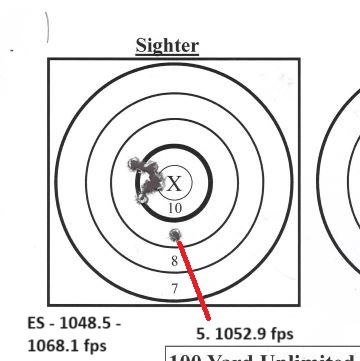

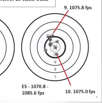

Below are two examples that I observed this morning. The first is the first ten shot group I shot with a lot of M+, the second is the last ten shot group I shot with the same lot. Ammo MV had increased with this lot as time passed.
In the first example, nine rounds went into a "group" and there was one stray. The nine rounds in the group had MVs from 1048.5 fps to 1068.1 fps. The stray wasn't errant because of its MV.
In the second example, two rounds, shots 9 and 10, had very nearly the same MV but they had very different POI, separated by almost one inch of vertical.
