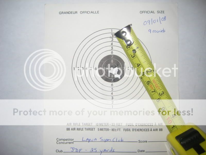

I actually found a 25 yard target in my notes...dates and extra info is in the photo. This was the zero I used before trying my first time at 200 yrds. Again, this is with my BRNO #4 with a 27 inch barrel. Ammo was Lapua Super Club. Not as good or nearly as thorough as Lectors work I know...:redface:
That is a nice group for 25, and I have to say that I have personally seen the Dlask barrel do that consitently and even better that with some of the cheapest ammo found on earth. I don't want to be the only one saying this though I hope some other people start posting there results soon.
Yeah and I guess that's what the thread is about. You get these results using Dlask barrels with sh!t ammo, not target stuff. So the value is very high with the Dlask barrels considering you get great results using inexpensive ammo.
