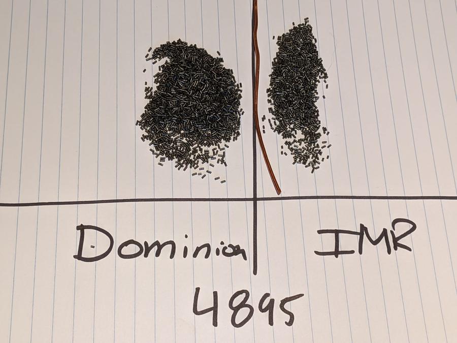

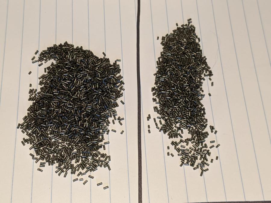

I did another test today:
22C at pretty much sea level.
Remington 700 heavy barrel 26" in 308 win.
USA brass (Winchester) all full sized to my gun. .002 bump. Trimmed to 1.995 then sorted to 157-158gr.
Sierra 168gr matchking HPBT seated at 2.875"
Fed 210M
All powder charges thrown on a Chargemaster lite and trickled on a RCBS 5-0-2 scale. Which has been checked against other scales and weights.
Labradar speeds
15 shots each of 42.5grs.
2 foulers at start of range trip. Allowed to cool for 30m untill it was this guns turn. Then allowed to fully cool before the next powder group
IMR 4895
Avg 2535
High 2560
Low 2504
Es 57
Std 14.5
D4895 current Lot 1459
Avg 2561
High 2589
Low 2544
Es 45
Std 11.4
Prehaps a slight accuracy edge to the D4895. Could be as that is my standard load. Both shot 5-3 round groups under 3/4" 100yds.
Faster or slower?
It's great powder!
I will do a similar test with the D4350ssc next

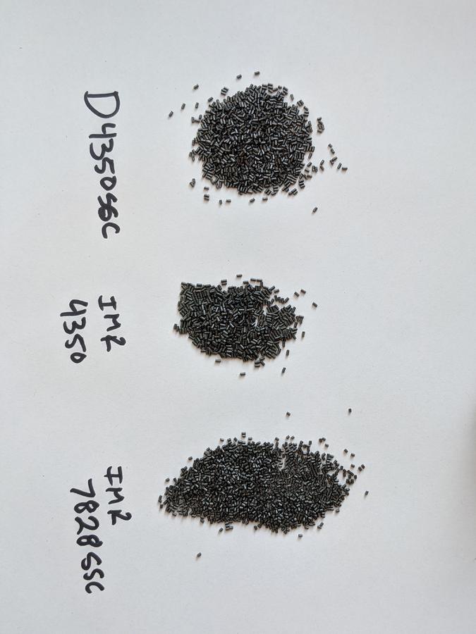

My latest test. D4350ssc.
Gun:
Rem 783, 6.5 Creedmore 24" heavy barrel
Ammo:
Virgin Hornady 6.5 Creedmore brass. Trimmed to 1.910.
Weighed and sorted to .5gr
Fed 210M primer
140gr Hornady SST weighed and sorted. Within .5gr (I wanted to use these up)
2.690coal.
Charges weighed on a RCBS 5-0-2 scale
18C at 300' elevation.
Labradar speeds 10 shots each load. Which was verified with my known 308 load.
Load A:
41gr IMR 4350
Avg 2567
Hi. 2593
Lo. 2548
ES. 45
Load B:
41gr D4350ssc LOT 25
Avg 2450
Hi. 2475
Lo. 2432
ES. 43
The ES seems high.
Only did 10 shots today as I didn't think there was any need to get a larger sample for these 2.
As for accuracy. Neither.
I added the 7828 as it is the only SSC I have.
I would say the D4350ssc is a considerably slower powder. Maybe even closer to 4831 or RL19 as some have already suggested. I had some IMR 4831 loaded up but not that low.
Even the IMR4350 is 150fps slower than the Hornady book using the same ingredients. Hornady shows 42grs of IMR4350 as a max load.

Great post. These posts really need to quote the Lot # of the Dominion poweders so they can be used as a reference for others down the road.
D4350ssc lot 25.
Added it to the post. They are in the other tests. Missed this one I guess.
Do you need the lot# of the IMR powders?
