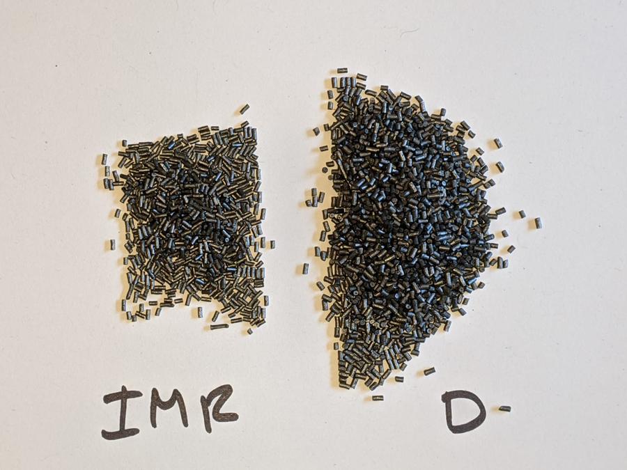

Thanks for the test Ruger007. Looks like those 4064 powders are nearly identical, maybe the d4064 is a touch slower. Was the grain size of the imr 4064 a longer stick compared to d4064ssc?
4064
I would say without getting the micrometer out that the D is slightly cut shorter but a bit thicker. Prehaps a slight change in color?
