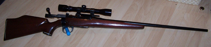

I picked this up recently, and introduced it in the Milsurp section.

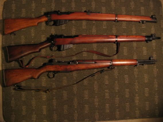

Well, compared to some very nice rifles in here, I don't have all that much to offer. My grandfather gave me his old Lee as a gift. I love it to death, accurate and in fairly good condition. My only complaint being how bad it kicks, but someone was kind enough to point out that this is because of how thin the butt is. Mine is the one with the original stock.
without further ramblings: My 1916 and my uncles 1918
