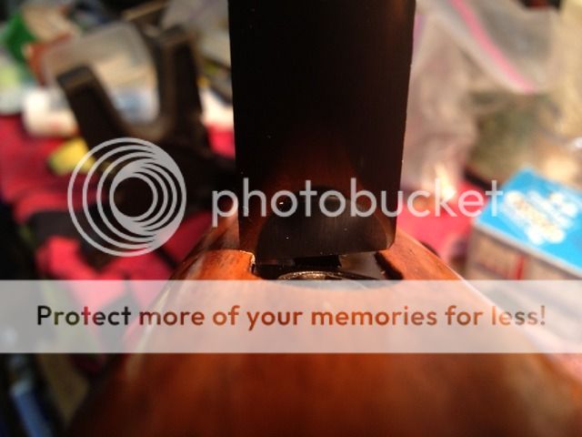

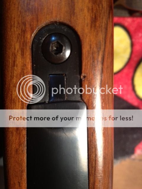

Hitzy: My rifle was also free-floated to the about 2" in front of the action. Normally, this isn't a big deal - back in the day, it wasn't uncommon to bed the first 2" of a barrel past the action and than free float the rest so I think this was done deliberately. I added a washer to the front action bolt under the receiver to free-float the whole barrel.
