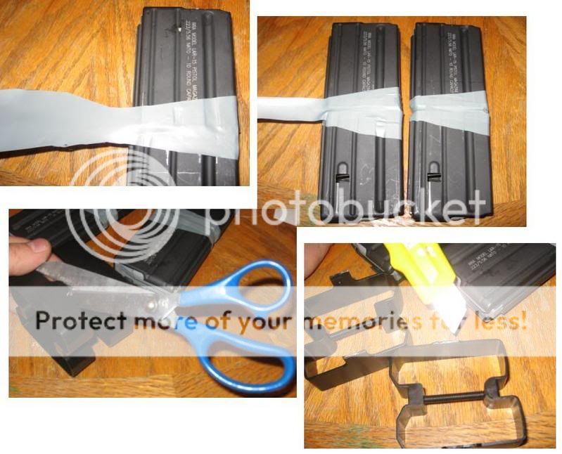

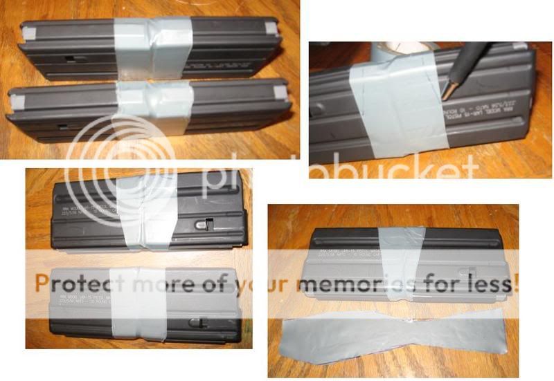

To make a Full Deck, the magazines are joined so that the followers face the same direction. Use tape with an ability to stretch tight. After taping the magazines, it was found that the tape hindered locking of the magazines without force. So, the tape needed to be cut down and shaped so that it follows the magazine well shape. Finding the right shape for the tape takes the longest time and keeping a template is a good idea.
Stretch the newly shaped tape around the magazine to join the two magazines. I then added a narrow band of tape around the circumference for added strength. The First Samco joiner can be cut in two easily with common scissors if that is all you have. Use a knife to trim excess plastic if you wish. You now have an extra Full Deck joiner for your next four magazines!
Place the joiner round the magazines where they meet. Insert the Full Deck into the lower, locking each magazine in turn, adjusting the band if needed. When all magazines lock easily, you have found the correct location for the joiner. Use a flat tipped screwdriver to tighten the joiner. That’s it! It works and it is fast. Enjoy.

I can't say that I am a fan of the design - it is innovative but I really like the fact that the magazine holds 10 rds but it isn't in a 30 rd body. I really would love a 20 rd body (I think it is the perfect size). The way you have it now the mags will be in the dirt when you are shooting from the prone position - could cause reliability problems and I like not having a mag resting on the ground from the prone... Good idea to increase cap though...
