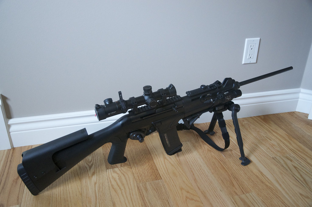

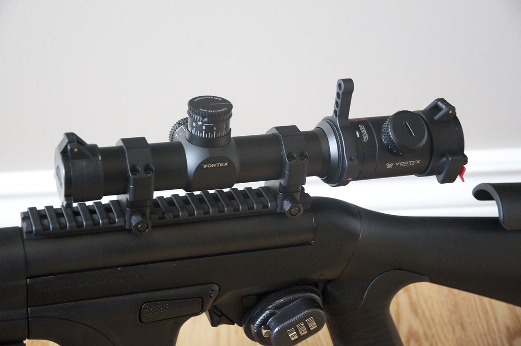

ATRS had my rail shipped by wednesday but I Only got it today as I was out of town. Got her installed (broke another t15 bit) and here are the photos. As you can see, I now have space for my 3x magnifier. Thanks ATRS. Good quality product.

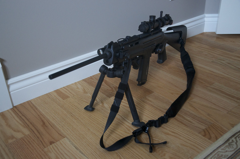

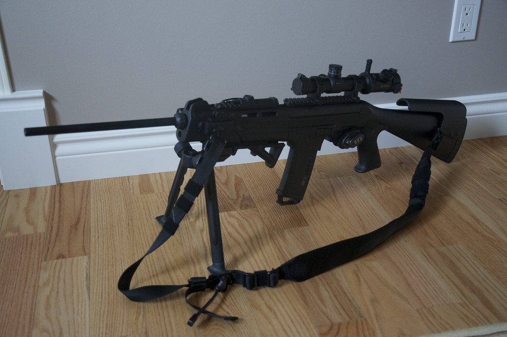

Here she be, all done up with my new magnifier...
https://lh6.googleusercontent.com/-mlMla7yM-lY/UFz0BGk5UlI/AAAAAAAABvo/lEQE###UTR8/s720/IMG_1017.JPG
Each side of rifle with the magnifier stowed and unstowed
You did a great job on your rig. How do you like your scope?

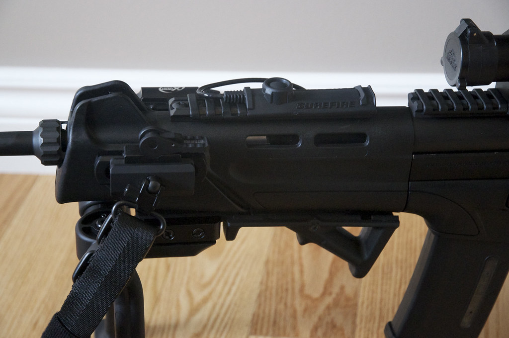

Really like the scope. Clear, smooth operation. The bipod is a Tango Down, works great without all of the springs, levers, etc sticking out everywhere. It's self centring for cant and swivels effortlessly. The sling mount is an American
Defense AD-BP.

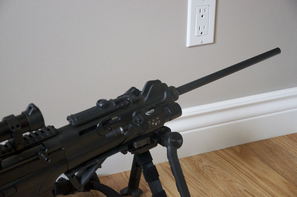

The Surefire is an X300 with XT07 pressure switch. You can guess how it's mounted.........yup, with the original rifle scope rail. The Mesa Tactical cheek riser completes the project (mounted with Chicago screws) and places the rifle exactly where it should be finally. Bringing the rifle up now puts everything in position without all the fussing trying to get a comfortable shooting position.:D
I figured you used the original rail for your switch. I have to say, the solid stock looks nicer. I'm glad you finally made it work for you. The whole package makes it look like a solid medium range platform. I say medium because .223, and 4x scope limits effective range. I wonder now if I took my original rail and mounted it on the bottom of the foregrip to get the same effect you have. How did you work that railinto the original tri rail?
The bottom rail is from Magpul, a shortened 4" model. I trimmed out the centre of the rail to fit the curvature of the hand guard. It just so happened the thickness of the Magpul rail lines up perfectly with the Tri-Rail, allowing the AFG to slide partially onto both rails, providing a very solid mount.
All the fiddling didn't work out the first time and I ended up buying a couple different Magpul rails. In the end, it was worth the risks. The rifle ergos are now what they should have been from the factory, short of the screwy mag release position. That I can live with. :D

Right, the Magpul is tight to the Tri-Rail. I enlarged the diameter of the mounting holes in the Magpul rail with a Forstner bit, to accept Chicago screws. A larger bearing surface makes a better connection.
You're right about the vertical grip, tried it, it sucked big time. You end up holding the rifle up rather than pulling it in toward you. The vertical grip just doesn't work with this rifle.
As I said, the release isn't great, but I can live with it. It certainly isn't the worst.
