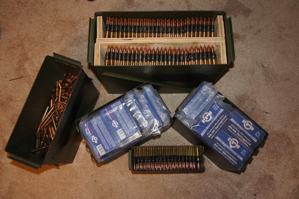

By the way, stock up on 308... you are going to be shooting a lot of it once you get proper belts. (Plan to invest on either a linker or belt loader depending on your choice of belt, saves hours and fingers)

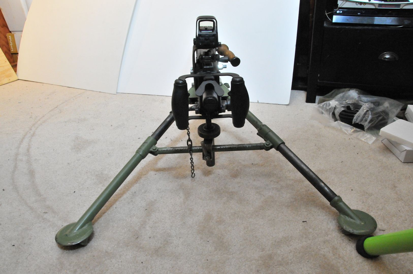

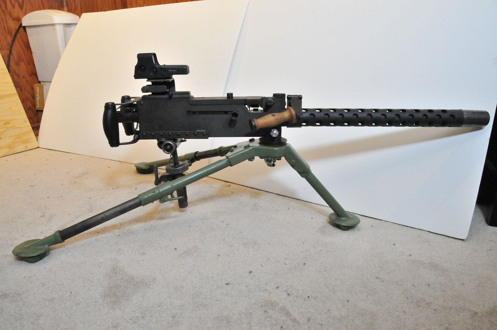

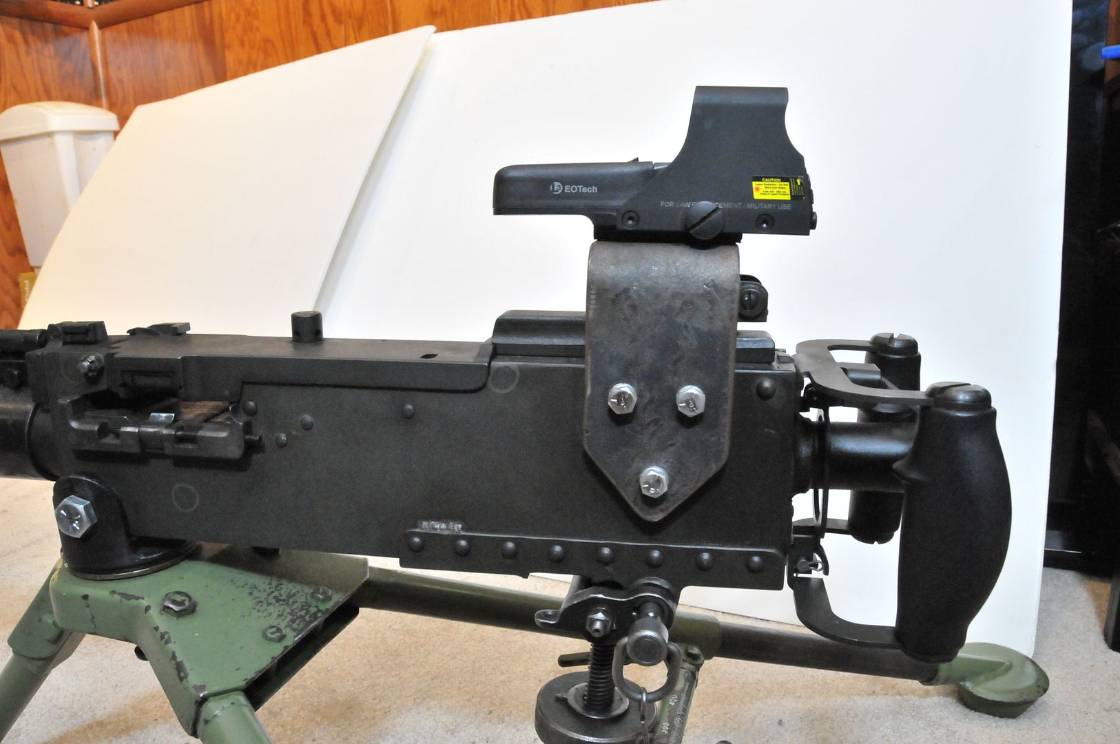

I also added a homemade optics mount to my 1919. (No modifications whatsoever to the gun, the tapped holes are part of the design.)
The combo of the eotech and the spade grips lets me rip off ammo accurately and fast. Everybody that has a semi 1919 should have these lol.
