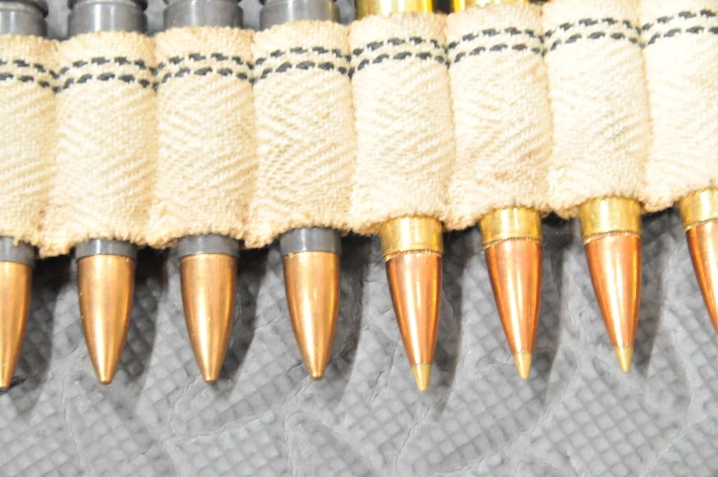

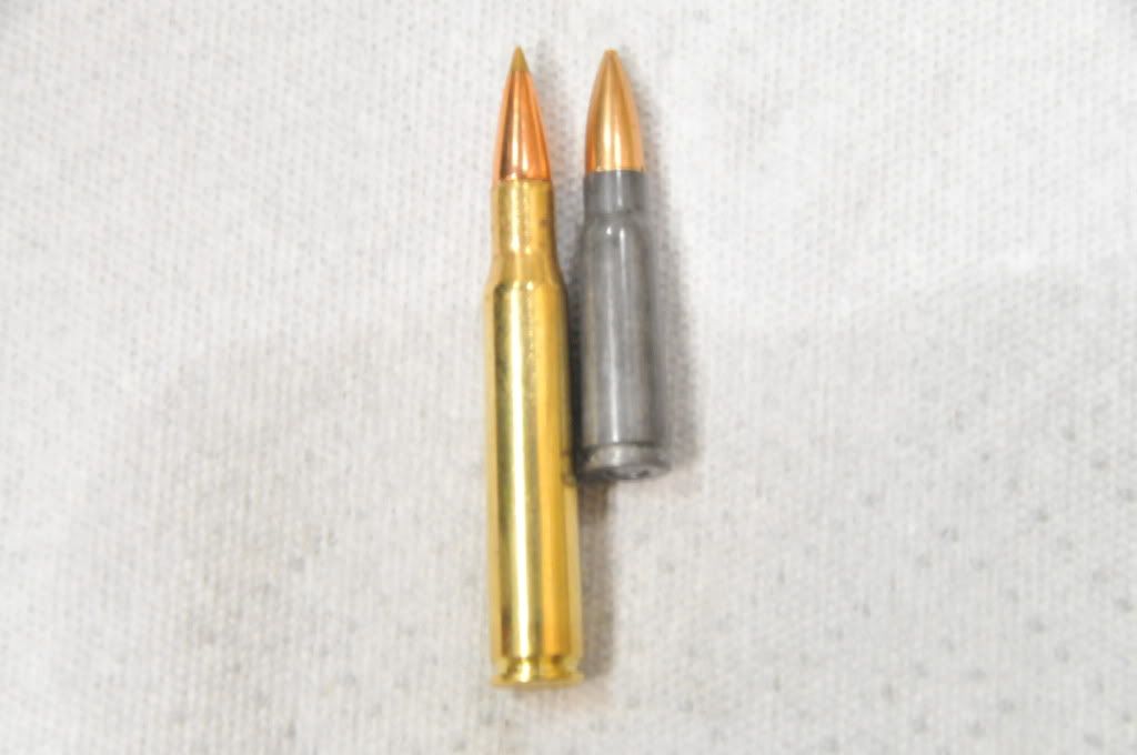

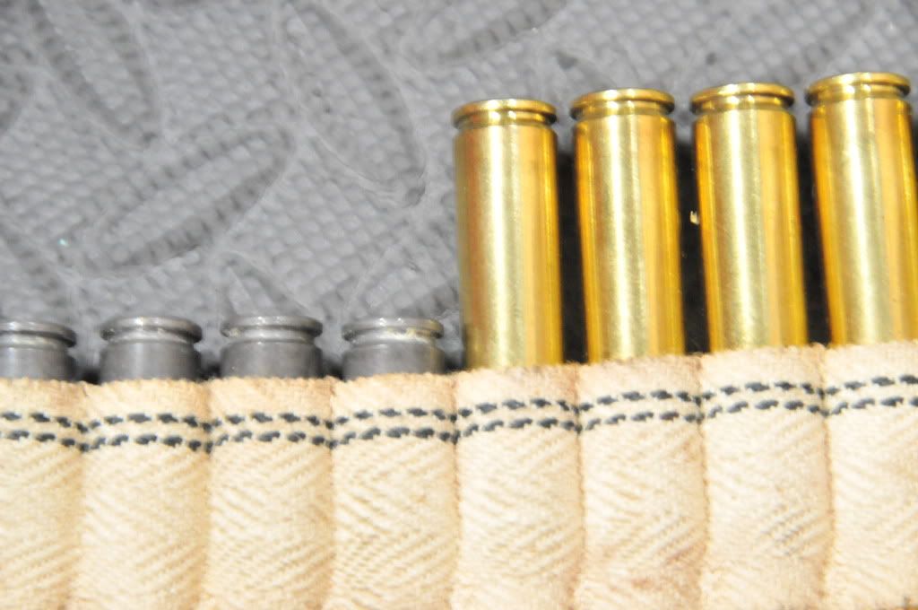

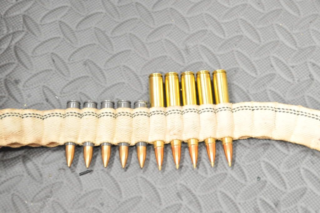

Will .30-06 link work with .308 ammo?
NS
Yes, fits no problem.
I'm not sure linkwise, but I know that 7.62x39 also fits perfectly into the cloth belts. I would love a conversion for that caliber, as I have buttloads of crates stacked up for it, but I lack the skills to pull it off. It would make an awesome shooter/ plinker for the range dont ya think?
