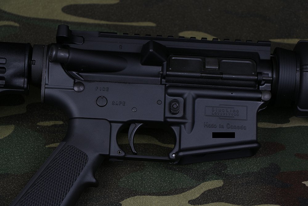

Is that the lower that you got through this sale? Mine does not have the engraving on the other side and the finish is nowhere near that good...
Both mine do not have the engraving on the right hand side. I kinda like that, like the lower more blank than logo'd up, gives you some options if you want to put a custom mark on it!
More eye candy. The Spike's upper I put on is just a touch more matte black.
Here's the pin I had to sand down a bit. You can see that it still has its shape.
The whole rifle. The shiny parts are oil spots.

The detent pin hole is not off..............it is the trigger group milling out that is the problem. The radius is larger on one such that it has broken through.

I don’t mean to be all over you here but what do the markings and recent anodizing have to do with the takedown pin hole and the safety detent hole. Basically what I read here is that we should have known about these issues years ago. I even referenced a thread from January 2011 that points out the issue with the rear takedown pin on 2 receivers. What gives?
I suspect that all that happened was an incorrect diameter of mill was used for part of the batch. Running identical patterns on the CNC center one would think that they would all be perfect..........but not when the wrong tool is in place. The location of the detent hole makes one really have to look for the problem............but if it is there then it is quite clear once one sees what one is looking for.
