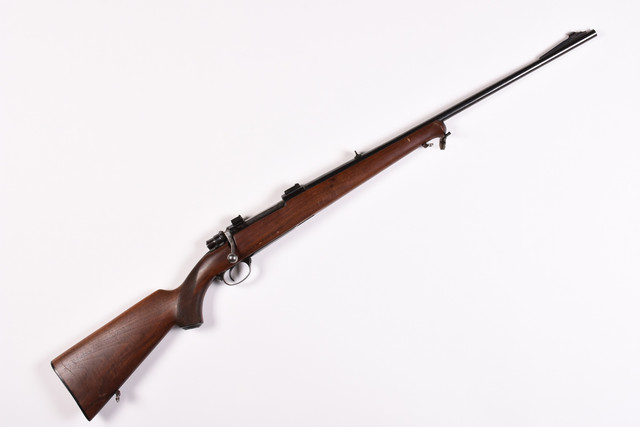

Hi there I just recently picked up this husqvarna .270. Not one hundred percent what the rifle is, from what I have found it’s a 1900 action, as far as the series?? 8000? Bought off a friend very reasonably, after my main hunting rifle developed some issues in our hunting. Thanks! This has been a neat sticky!
https://photos.app.goo.gl/UMGyVHWb63XVSgYx8
Happy New Year sthorvictor
Before being able to answer your question as of what "model" it is, I need to know what the left side of the action says. Then, I need to know the serial number range and the sling swivel size (1" or 3/4"?)...
