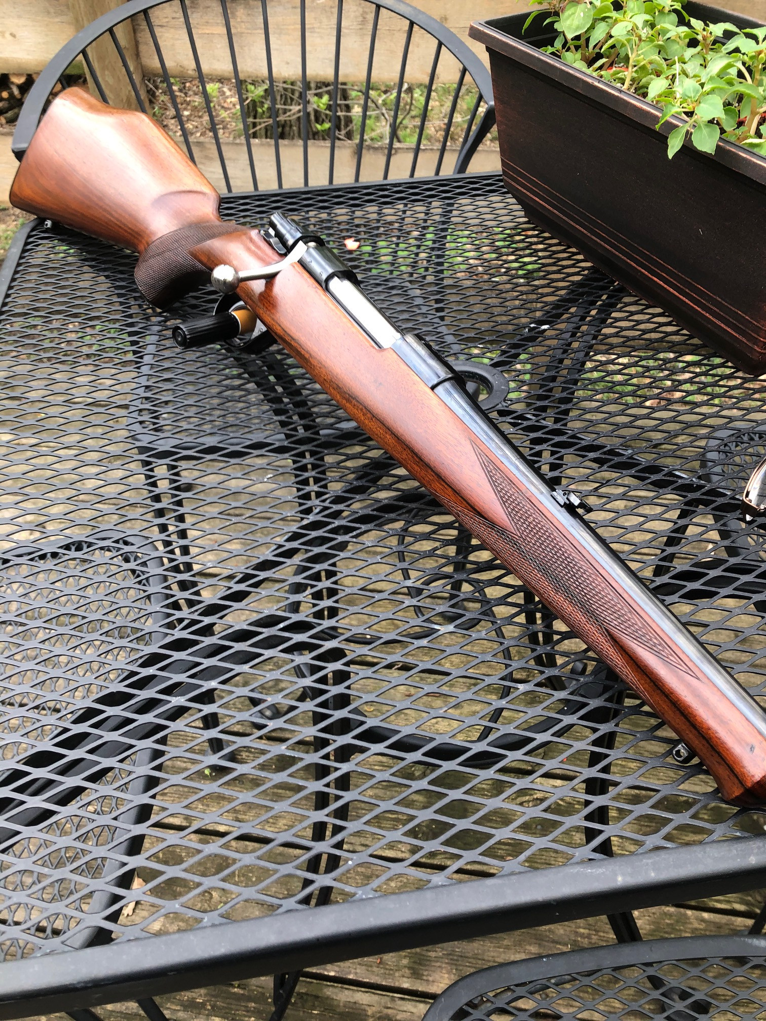

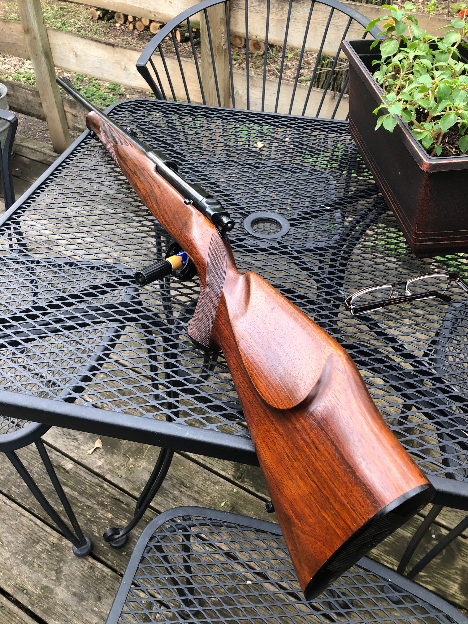

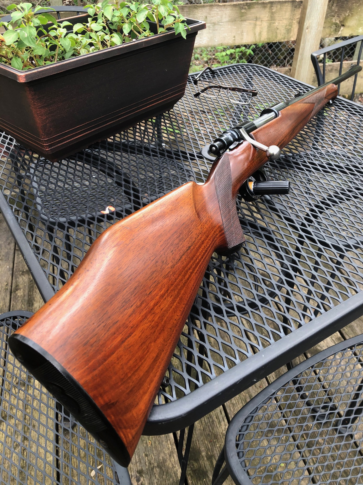

What you have is a late 640 made on the "commercial" FN '98 action and with the plain beech stock made late 1953 (the year HVA introduced their Improved Mauser 1640 action. You're lucky to have the front sight hood. Other than that, it's pretty in original condition, except, maybe, the sling swivels.
Thank you!
