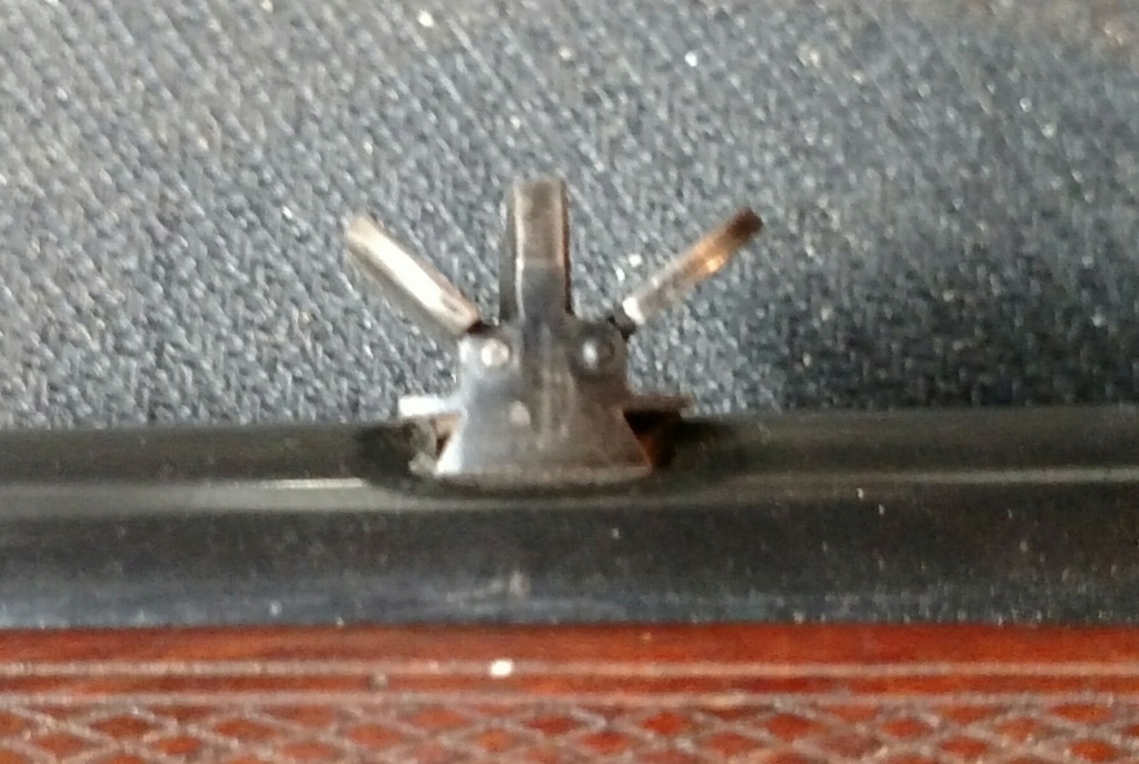

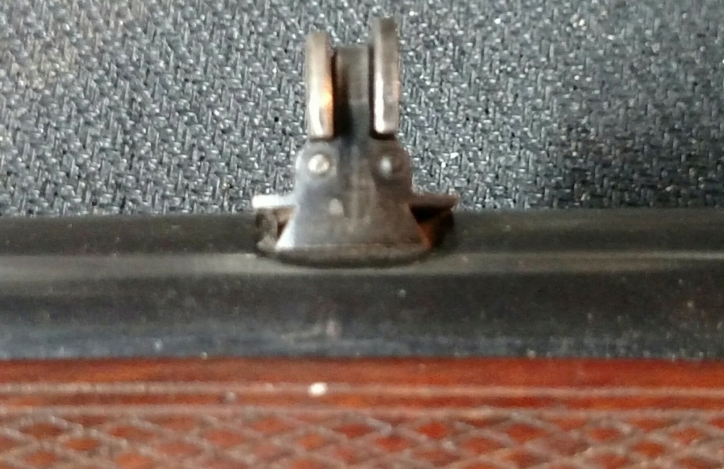

Anyone have a spare Husky folding rear sight in their takeoffs box?
Hi all:
Bill Leeper is finishing a custom version of a Mannlicher stocked Huskvarna Model 5000 (or whatever) with a replacement barrel and a Mannlicher stock made from a single piece of wood stock blank, unlike the original two piece Mannlicher stock. Bill has shown he's just as good at carving, inletting, and checkering stocks as he is good at building tack driver hunting rifles. I wanted at least one of my rifles from Bill to be stocked by Bill as well. He has used the original action from the Mannlicher stocked Husqvarna I gave him: everything else from that rifle is still in one piece awaiting an action to become a rifle again.
What I lack is the folding three leaf rear sight to install on the barrel; BUT, I don't want to pull the existing rear sight from the original barrel. Anyone have a spare rear sight like this you'd be willing to part with, and if so, how much?
If it is not in perfect condition, it would probably be okay: the rifle is chambered in 35 Whelan. Bill will be adding some metal and then regulating two of the sights for the jacketed bullet I will be using, and the third leaf regulated for the 250 grain cast bullet I use in my other 35 calibers.
Thanks all for taking the time to give this your consideration. PM me if you have something to offer.
