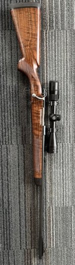

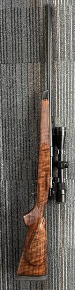

What type of 98 action would be on this Husqvarna FN, 640? I’m asking because to use Leupold bases I had to use a shim under the rear moun to get it level, I’ve run into this before on a 98 Zastava Leupold sent me some shims explaining the 98 action has many variations shims are required on some models.
Another curious item is a third Magpul sling mount just forward of the trigger guard what could it be used for?Feb 71side.jpgfeb 8 3bottom.jpg

If you know it's a HVA FN 98 action, then you have your answer... it's very hard to tell which version of the variations it is from these pictures, as per the rifle was heavily modified.
I have used a lot of Leupold mounts with these rifles and usually they are easy to fit well...
Edit; It's a FN98 post '49 ``Commercial`` action.
