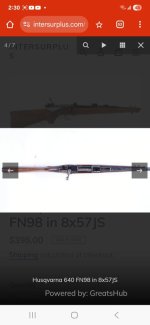

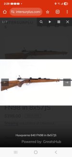

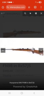

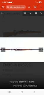

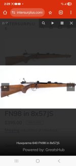

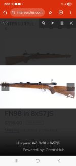

Alright well thanks to you guys and your bad influence on me I bought another husquevarna 640 in 8x57. Im just curious as to what peep sight would fit on this thing.
