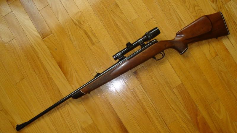

Here is my husky, in .308. Fairly new to me; I love how this rifle carries and fits me. I hope to find one in 7x57 one day.
From what I can gather from your pic, it looks like 4100. Can you either post a full-lenght pic and / or give you barrel length and partial S/N (ex 2326XX).
I am compiling infos on the HVA rifles.
The S/N of my husky is 2002xx. The barrel is short, like 20 1/2 or 21 inches. The stock has a cheek piece and does not drop or have a raised comb. I would be pleased to know the year of manufacture. Thanx!
520mm, that's what your barrel lenght is.
Your S/N makes it a 1959 production and it's an "Export" model 4100.
I will try to get some spare time and make a table to serialize the HVA repeating rifles.

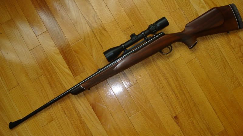

There's recently been a new addition to my Husqvarna family, now the Husqvarna "Triplets".
The most recent addition, a model 3000 in 270 Win.

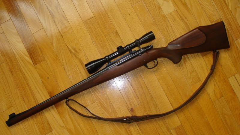

Model 4000 Lightweight in 30-06

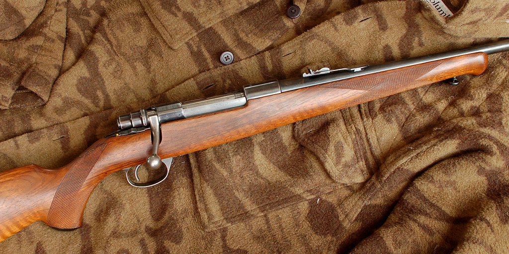

And a short while ago I picked up this model 1651 in 358 Norma Magnum, which will hopefully be this years 'Moose medicine'.
Nice CG, Smokeeter,
Just for those who don't know it yet, the CG 1900 rifles are actually the SMOOOTH operated push-feed development from Husqvarna model 1970, made only 1967 to 1971 with the HVA name.
In 1971 HVA merged with the Carl Gustav Stad Gevarfabriks, becoming FFV (Forenade Fabriksverken one of the Swedish State owned arms company). The 1970 model then ended up being marketed under the Carl Gustav, Husqvarna being mainly used for the shotguns until 1989.
The model 1900 and "derivatives" 2000/3000/4000/8000/9000 models were made in the CG Eskilstuna plant for some time, ending up late '78 early '79. But the procduction continued stil using the CG name, with rifles made under contract in Belgium, then in Italy and ending up at Antonio Zoli's plant in 1989 (and they continued stamping Carl Gustav on it).
There were some Zoli-made 1900 stamped with the Husqvarna name in the late 1980's and maybe even later.
There are two other Swedish compnies who made the 1900 (1970) design; Viking Arms and Geson. Plus there are also some H&K-made and some Merkel copies of the 1900 (197) actions.
There were also two
Johnn,
Your new acquisition is splendid. Maybe even too ###y for you. :D
Now, go get a real moose with your tag.:rolleyes:
