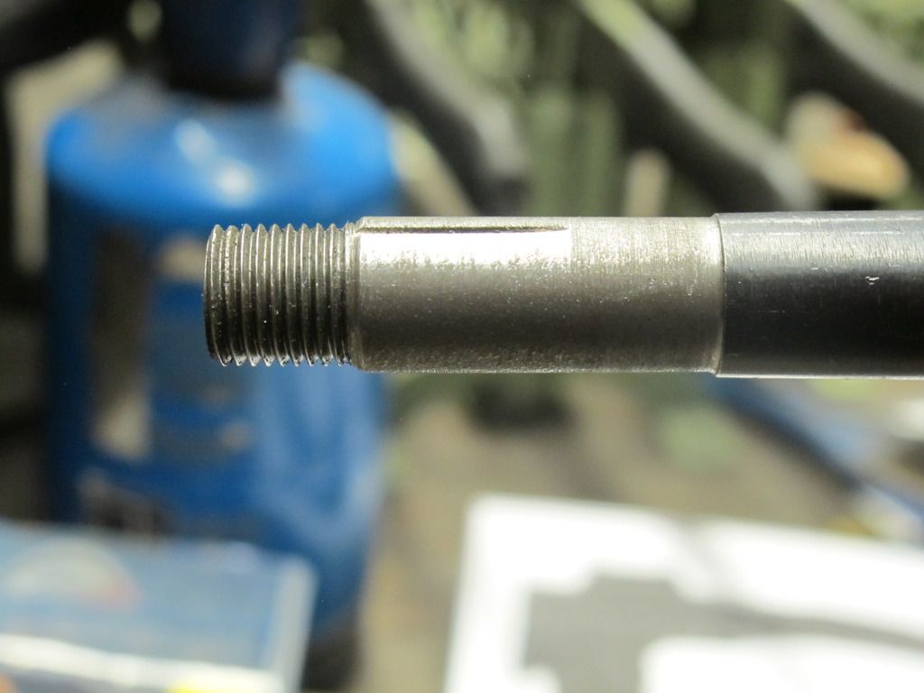

I cut mine down to 18 5/8 crowned it and cut a 1/2 inch fine thread on it. You would not believe how wonky a chinese sks barrel was to chuck up and put in a steady rest.

I've chopped 2 of my sks's down to 18.75 and recrowned them and there perfect.

the people that are telling you that this can't be done at home are noobs. I'll post picks of mine tomorrow.
nice photos
