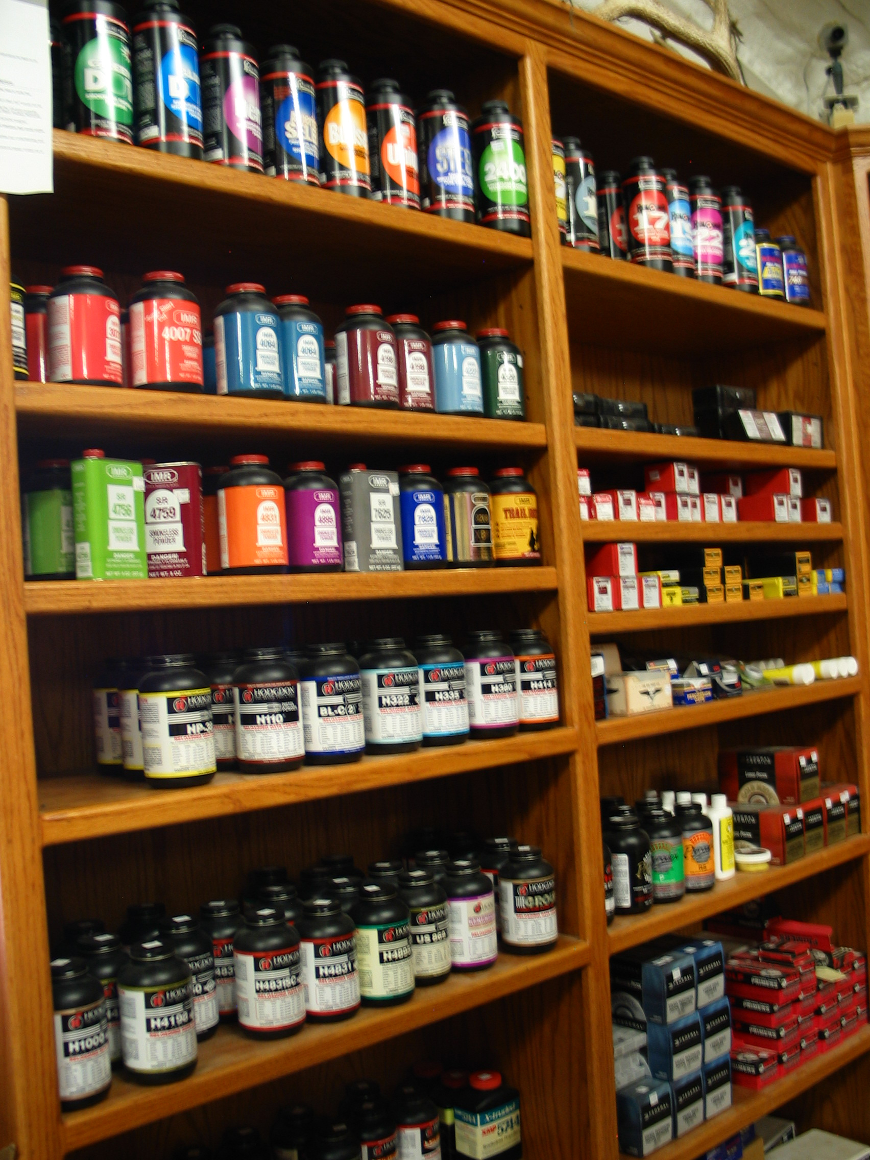

In this particular example it would be a good idea to separate the two 8lbs containers of reloading powder with as much space as possible. You could also put each container in document fire protection box. This doesn't obviously eliminate the risk it just reduces it. Bass Pro stores reloading powder they sell as per insurance and all manner of fire regulations. Ask them how they do it and what they recommend that you do. After all they would want to sell you more powder.
There's no need to ask Bass Pro. First off, it's not an employee's job there to be familiar with the storage regs for unlicensed users. The regs are significantly different. If you want to know how they do it you can also just read the relevant sections in the Act.
Secondly, it's no mystery what you need to do. It's literally spelled out in black and white in the Explosives Act. Just follow what they say. Easy peasy. No need to get some employee's opinion or come up with your own methods.
