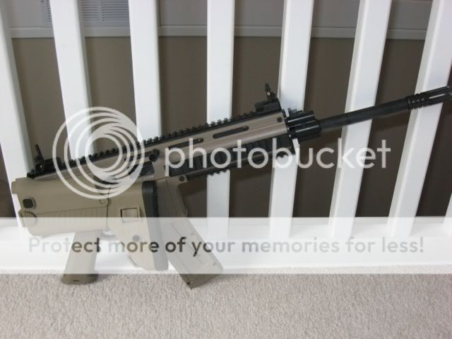

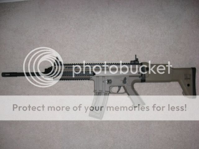

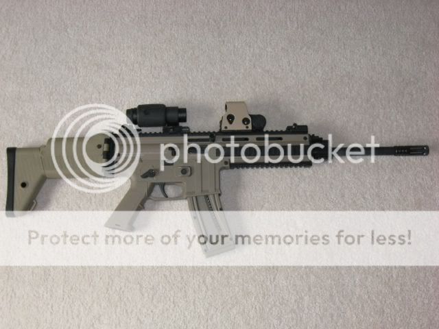

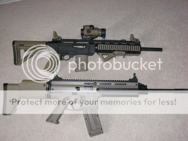

Heh, good pics Ballox. Nice team photo. :)
Looking at yours I'm thinking maybe the black is a better choice with the Mk22. I absolutely love the tan color and finish of the upper and lower, but the stock is a different greenish shade, texture and type of plastic altogether, and really detracts from the overall appearance. The black also suffers from the different plastic, but it doesn't seem as noticeable.
Hmmm. I wonder what a black stock would look like on a tan upper & lower? Any photoshop users out there that could do a quick coloring job...?
I have a tan one and noticed in photos the stock looks off from the colour of the upper, but in reality it matches perfectly

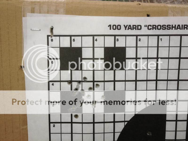

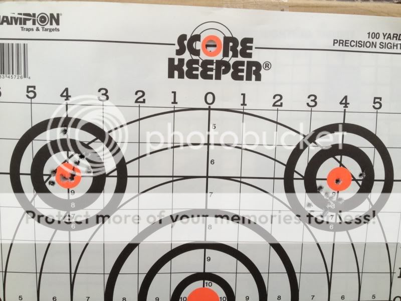

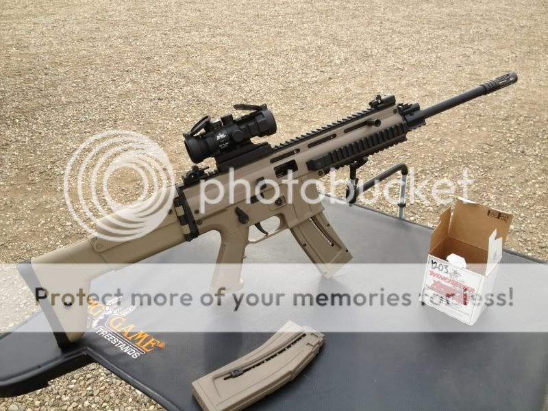

More shooting today. :) Round count is just shy of 1500, and still getting the occasional light strike on the primer. Friend of mine had 4 in a row with it this morning though, so I'm unsure if it's a hammer, firing pin or bolt closure issue (he may have been riding the handle forward).
After screwing around with the craptastic eBay knockoffs a Burris AR-332 was ordered and installed. Pretty decent sight with a reticle that may or may not be useful on a .22 at extended ranges. The dot covers 1" at 50m, and works well both on paper and the various metal swingers and rollers at my rimfire range.
Apologies for the iPhone photos...
Anyhoo, when she's shooting, she's shooting well. I still haven't gone over to the solid bench with sandbags to do ammo and accuracy testing, but even off the semi-wobbly swivel table I'm still quite pleased with the results...
