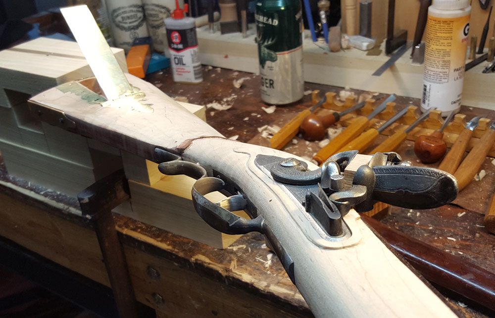

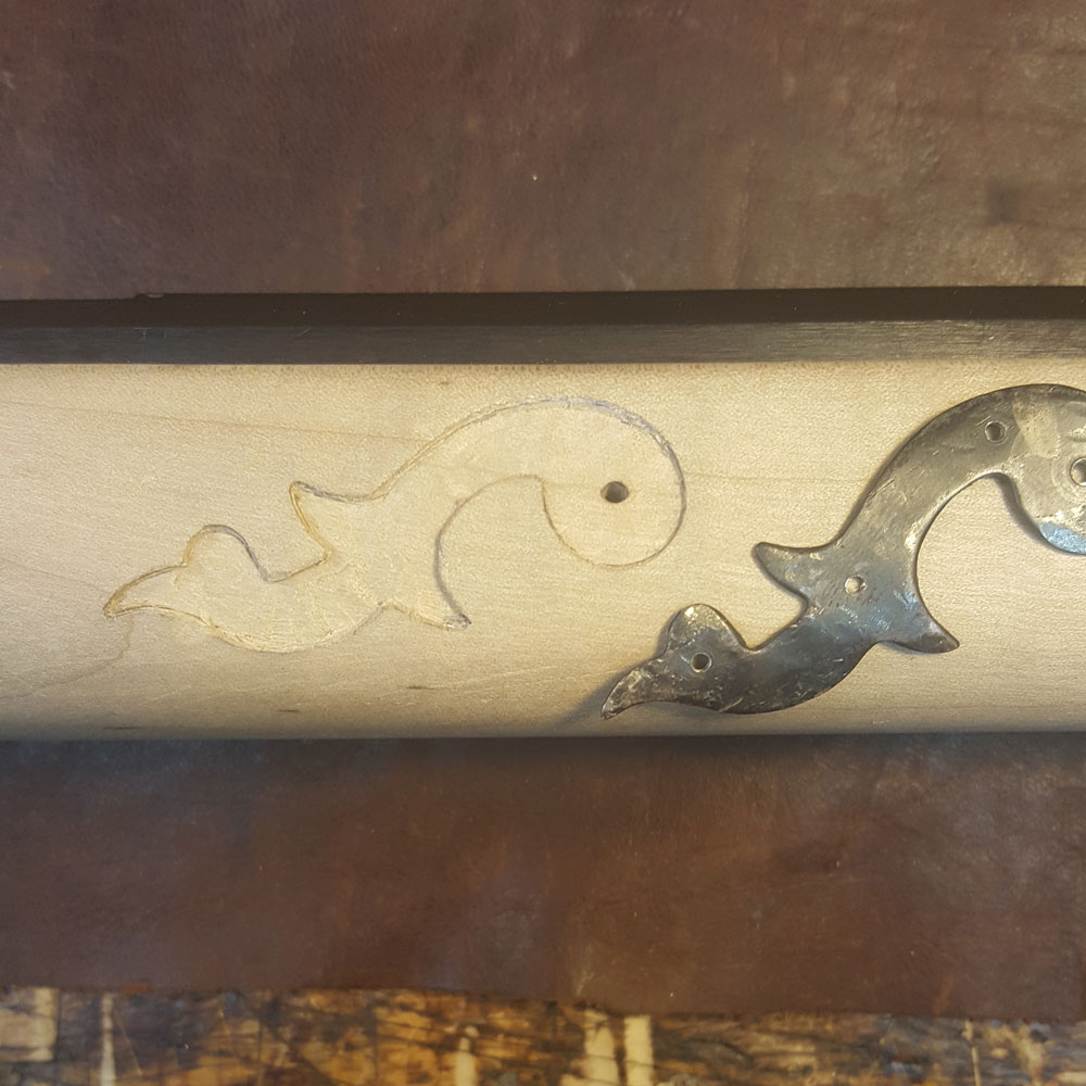

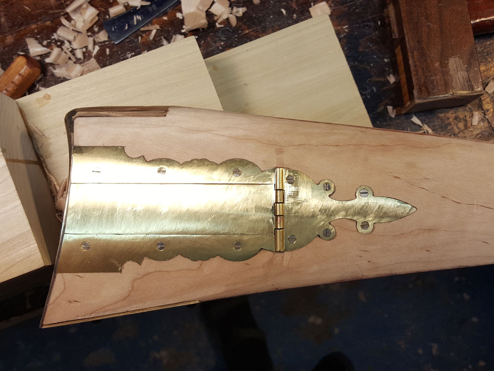

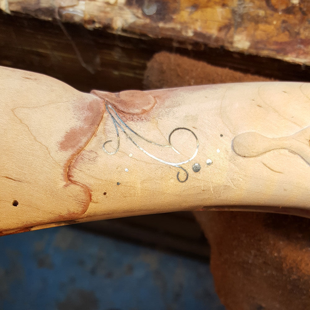

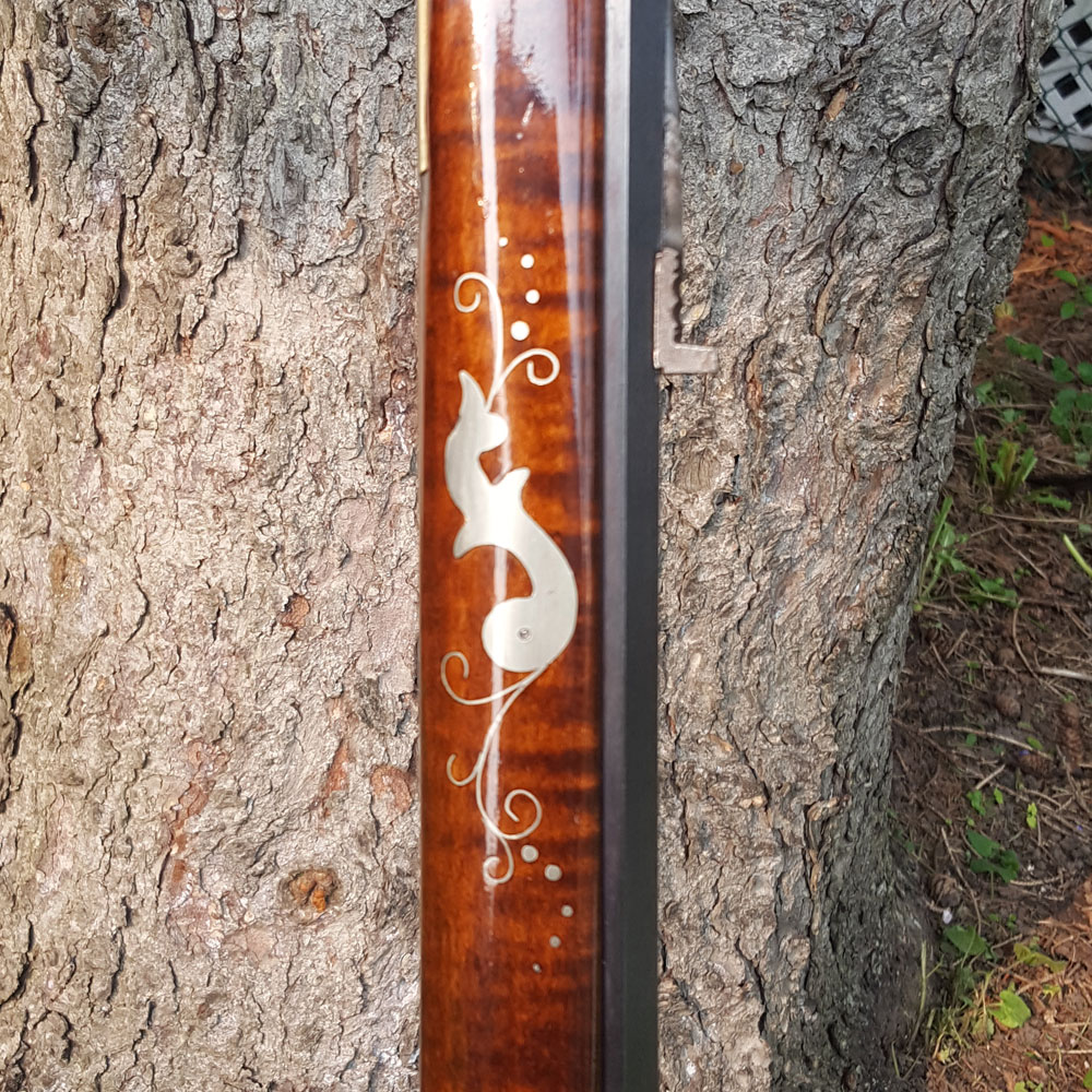

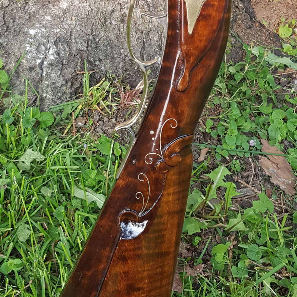

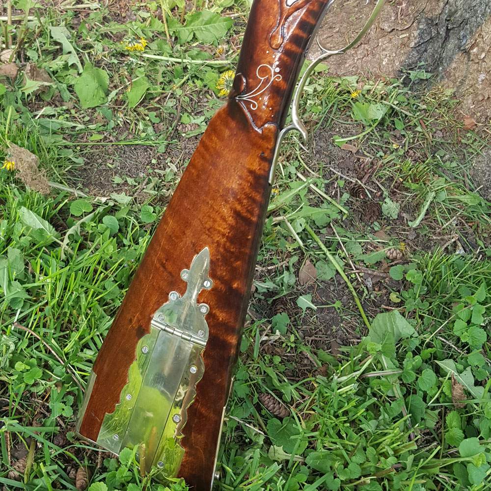

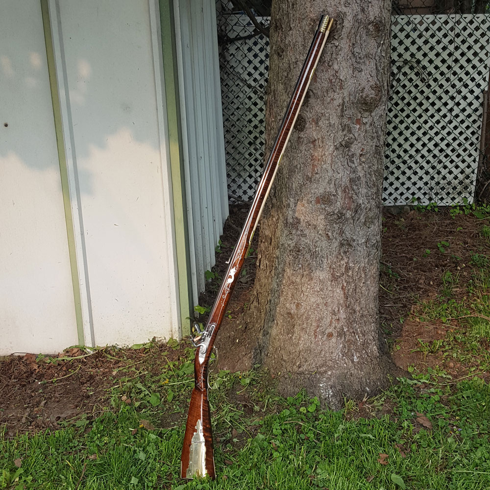

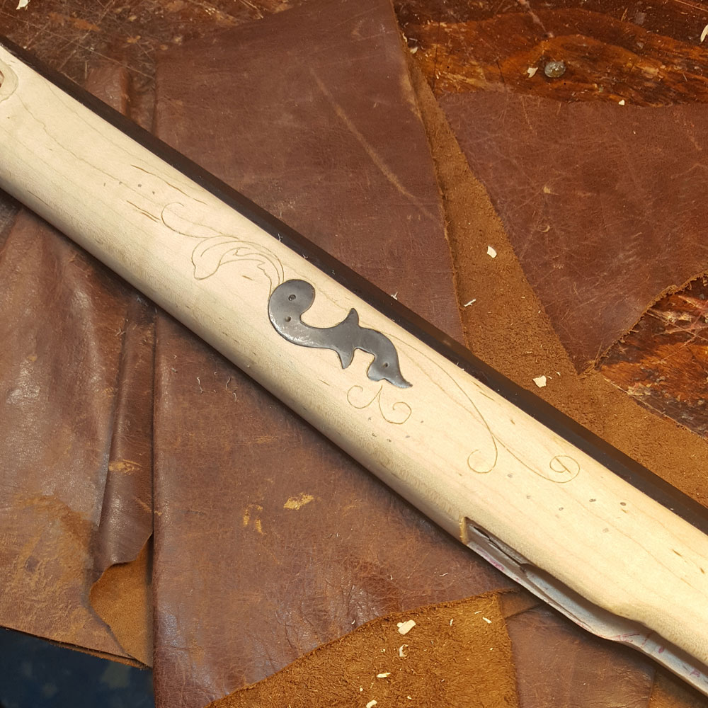

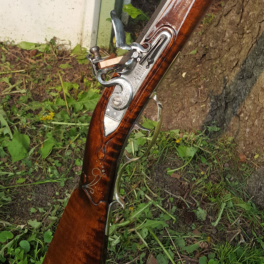

Just somethin I been working on ~ Been busy!!
Been a while .. been busy ...
Pretty sweet Sean,
Enjoy the free time when you can ;)
How does it shoot?

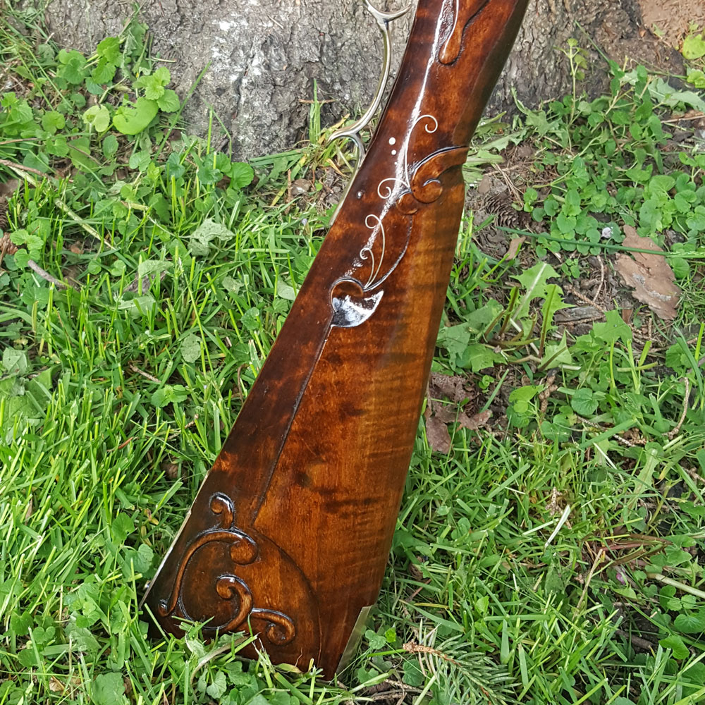

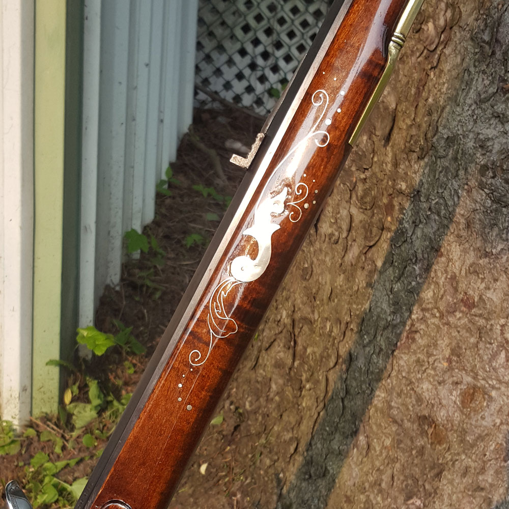

Thanks :) I have an Ohio half stock about to kick off... and 2 winchesters - wait, no 3 winchesters ... and a Kimber something or other .. and still that trapdoor (I should really call that guy..) , and another jaeger ...I think free time is in my past :(
It was on paper from the first shot - started grouping well at 80FFg .490 hornady ball and 0.010" patch (lubed) - though I think that can be improved with an 0.015" patch. Very pleasant to shoot :) FAST lock :) there is video of in on facebook if you wanna track that down: https://www.facebook.com/kimballarms/

Needs more smoke when you drop that flint Sean.
Very cool when seeing the fruits on ones labor !
Thanks for sharing the builds and continued success !
Rob
more smoke? you mean that or you jus funnin me? (that would have been the 100 grain loads ... lots of wind that day too so the smoke was gone pretty instantly.)
