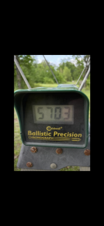

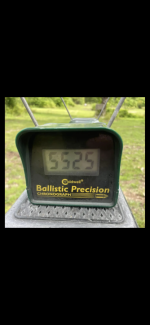

What caliber 220sw??22 cal 35gr Hammer bullet.View attachment 1141821
does that load group at speed also, would love to see the bullet after
