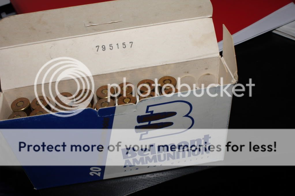

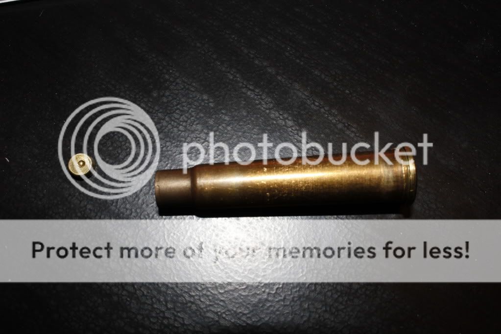

Here is a picture of the side of the round and the box, I took a look at my Remington 303 british ammunition and I see what you are saying about the primer being rounded. the belmont one is flat, so possible reloading?

Well - I havent bought commercial ammo in years - so I'm not familiar with Belmont ammo. But those cases are ex military cases from just after the war - hard to imagine that relatively new factory ammo would use these cases. How did you come by the ammo? It would be interesting to dissect a few to see what the charge weight is..
Wow, Those cases are WWII vintage, They still have the circular crimp on the primers. That means the primers are WWII vintage as well. (Because, you cannot reload this brass unless you ream the primer pocket its what make them hard to reload) Also note the primer sealant is visible, no one reloads with a primer sealant.
What is the bullet, It sais 150gr but this was originally a 174gr bullet. One has to ask if they reused the same powder charge or a home reload sold as a box of new?
The fired case looks stressed, You can see the chamber markings but most frightening is the ring at the back of the case before the rim, glad that bolt held after breaking. You are a lucky man...
BTW glad no one was hurt, but you know that is pointless to buy lotto tickets for a while.
Pete
I'm thinking that is actually WW2 surplus ammo that someone put in a Belmont ammo box. I'm going to go out on a limb and guess you did not buy that ammo new at a store. Either given to you, bought used, or bought at a gunshow - am I right?
Umm I did buy it at a store in the US. I have 2 boxes of it. The shop is off Guide Meridian road and just before division road in Bellingham. COuldn't find the name
Interesting. A guy on milsurps believes the Belmont ammo is tracer ammo that the projectiles were pulled from and new 150gr projectiles added on. No idea if that's true or not, and it would not explain the one over-hot round.
The case in the picture show signs of very high pressure.
I am not familiar with Belmont ammo but it looks like one of these commercial reloading outfits. I think that ammo was commercially reloaded because the wartime stuff I've handled didn't look like that at all. I have seen commercially reloaded ammo by Centaur in the Montreal area and they used primer sealant and it looked just like your stuff.
Don't fire the rest of that batch, pull the bullets and weigh the powder before dumping it to see if the charges are uneven from one case to another.

When the bolt snapped the "headspacing" would have been huge, don't mistake damage to the case as over-pressure due to a "hot load", the case damage could be a red herring.
