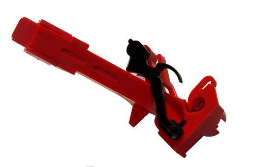

This machine
Uses this piece, and if this piece breaks, bends, jambs, gets a spec of fairy dust on it the primer dosent get seated, the primer gets crushed, the primer will go in sideways resulting in powder all thruout the carousel jamming everything or better yet if your heavy handed you could even have the primer go off (note Richard Lee speaks on this in MR2 and his solution is the flat primer tray instead if the tube magazine controlled feed units have).
