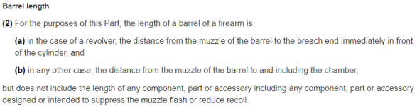

Not everything has to be specified specifically in a law, its absence also has just as much weight. Ones failure to comprehend it is on them. The law clearly states 660mm/ 26" is the minimum OAL, anything modified to be under is PROHIBITED, it gives no specifics, that measurement is made by inspecting and measuring it in a normal firing condition, be that with a 4" long fake suppressor or a thread protector. You make sense by reading multiple sentences and seeing how they apply.
The only reason the muzzle device is not counted for barrel length is due to this clause, had this not been mentioned separately, there is no other claim in the entirety of the firearm's act about it. If no statement were to explicitly prohibit it from being included, muzzle devices would have counted towards both OAL and barrel length.

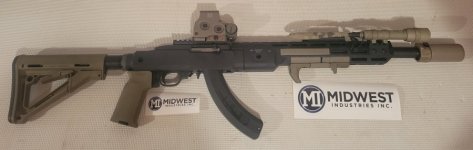

My Krinker plinker. I welded the metal button. There was no way you were pushing that button to unlatch the stock, without a grinder and drill.
Simple matter. Keep it 26" oal and nobody will care. Except you.

I have the exact same build as your pic same chassis with magpul stock and a factory made 10 inch charger barrel had to add an m4 flash suppressor and a thicker but pad to make 26.5 inches i dont like 26 always preferd a bit more length than 26. I can tell you this that folding stock will have to be pinned to not fold or it will be restricted
