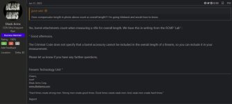

As per Dlask, barrel attachments are included in the OA length.
