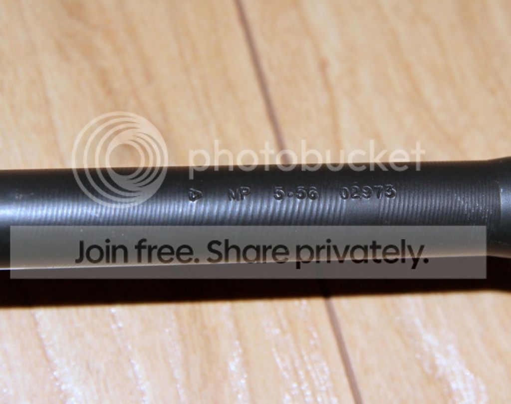

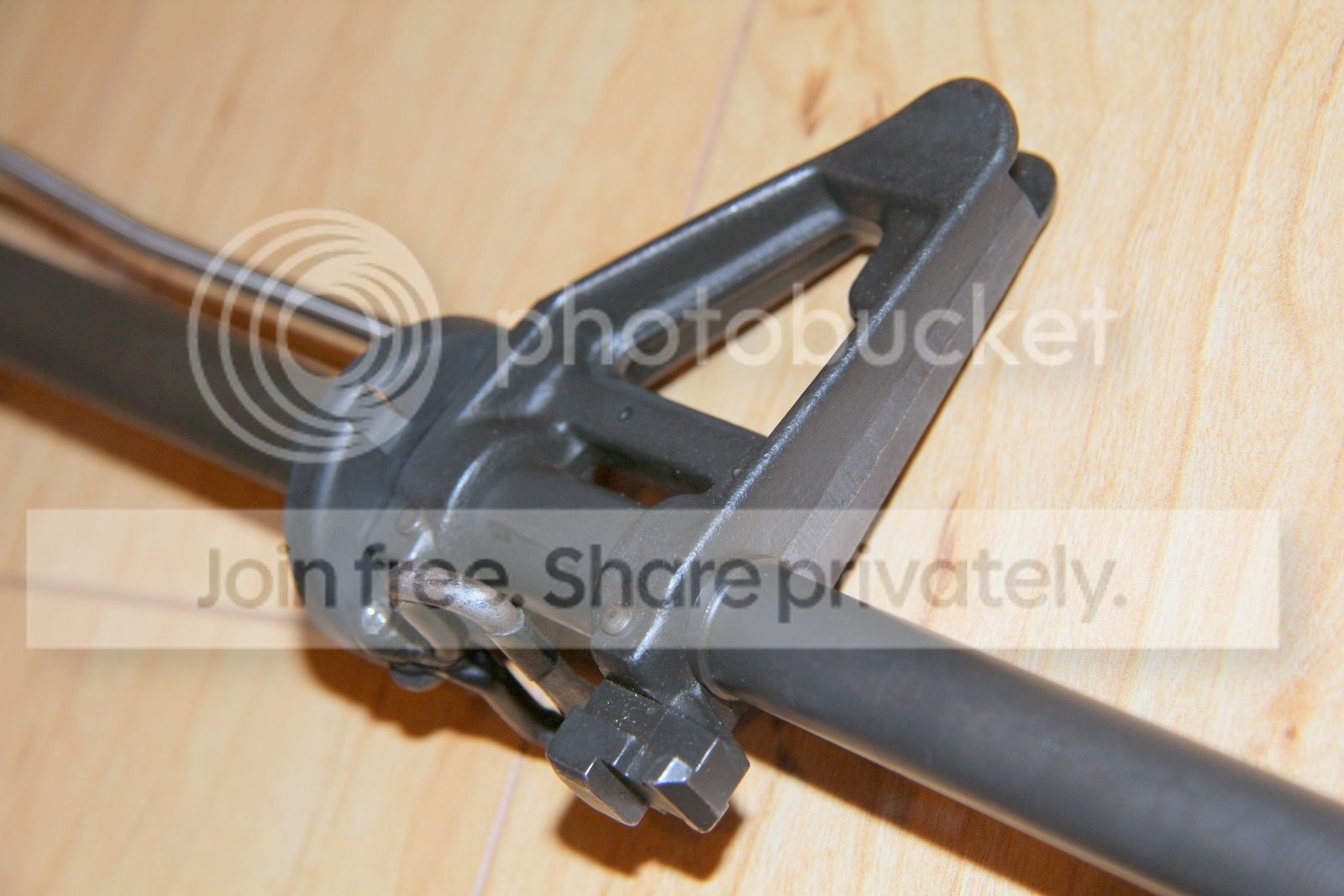

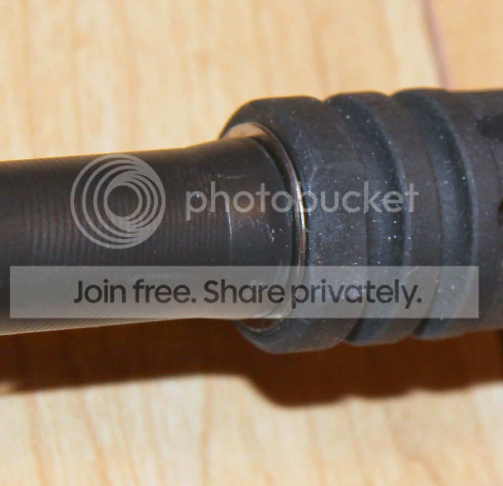

What does the contour of the barrel look like if not like that one? From what I've read and seen it looks like it's correct.
AFAIK the CF always used a .750 FSB. The rest of the barrel was a pencil profile but with a much larger flare at the muzzle (.700 or so). Unfortunately there isn't a lot of info out there on the original C8 and I've seen a lot of misinformation being spread over the years. Lots of people think it was the same as a Colt 723. It was close but not quite. Aluminum stock and the barrel profile being the most glaring differences.
Do a search and you'll find my thread on Arfcom. If you do a search here you may find Craftsman441s thread on him taking an M4 profile and turning it down to the proper one.
ETA: search doesn't go back far enough to find Craftsmans build. I haven't seen him around here much these days either.
