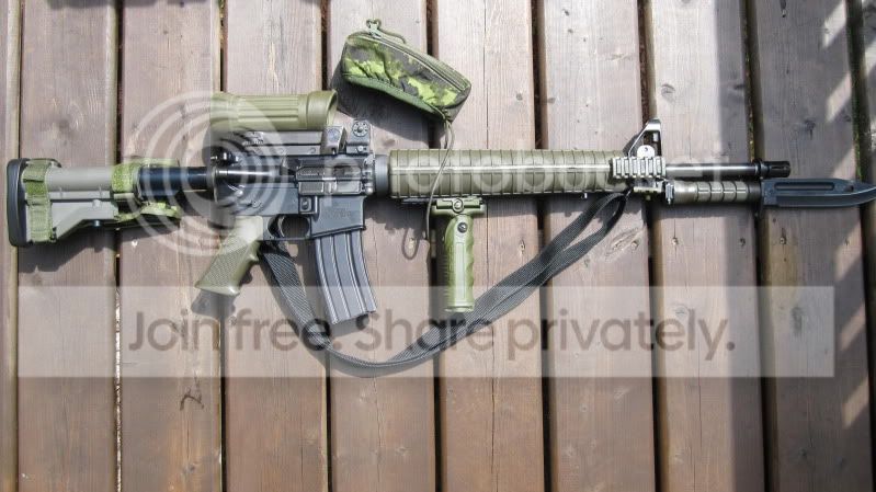

This is as close as I can to get mine to look like a C7A2 Clone. Otis grip kit, Ambi everything, Norgon ambi mag catch, ambi cocking handle. accu-wedge. Ambi selector. Even has the correct A2 mount for the C79. Still looking for an original new style bayonet, so the M9 will have to do until then. The receiver is a Bushmaster "Law Enforcment/Military only" model.

That is what I call a clone! Well done
The barrel on his C8A3 clone looks too thick to mount the triad. I had the same problem when I made a C7A2 clone with a stag HBAR 20'' upper.
How do you figure? The FSB in his pics all appear to be the standard .750". I can't explain why you had difficulty since the FSB on your Stag should be .750" as well.
+1. The Triad journals on the FSB mounting area between the pin bosses. .750" is standard one all but M16A1 pencil barrels and some benchrest barrels.
Dont worry.... They fit juuuust fine. :D

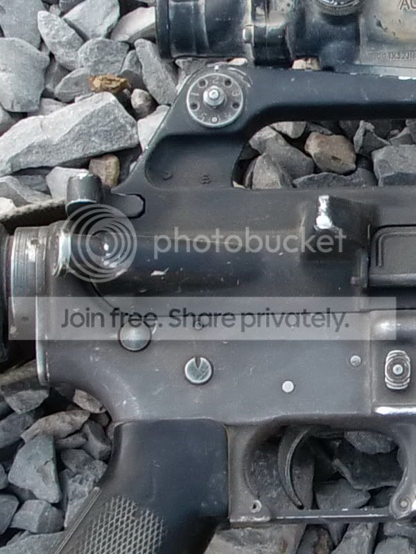

Claven 2: The selectors are DPMS ambis drilled and tapped to take a capscrew so they look like the Diemaco (but won't allow a slamfire). :thumbsup:

Yes. I know, I know. I know I need a different selector, one without the notch, and the lower shouldn't have FIRE and SAFE on the right side

Yes. I know, I know. I know I need a different selector, one without the notch, and the lower shouldn't have FIRE and SAFE on the right side[/COLOR]
That actually looks pretty cool, never seen that done before.
Why would you replace the selector? Notched ones are correct for the C8. You're right about the markings of course but you're pretty limited in what you can do, short of buying one of the clones.
Did you somehow shorten the ambi side of the selector? The DPMS ones are longer that what you show on your rifle (I have several of them).
