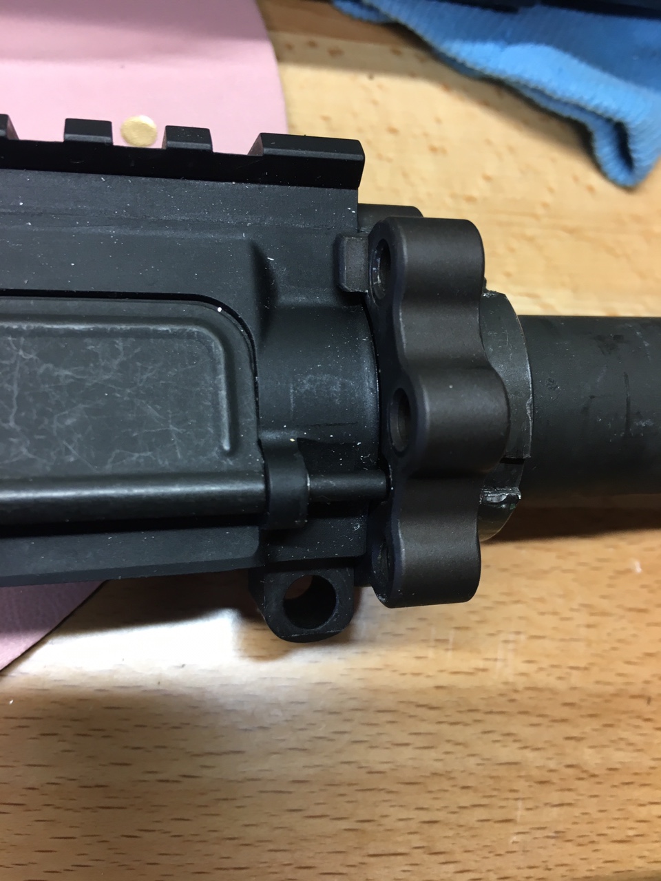

What is the upper receiver profile like at the hand guard interface compared to a mil spec upper? Will anti rotation tabs and DD RIS II/RIS III style hand guards fit?
Here is a photo. Anti-Rotation Tabs should be okay, so long as they don't interface with the rail itself. As far as a DD interface goes, I don't have a RIS example handy. Can you post a pic?
Looks like the anti-rotation tabs might need trimming, the bolt heads that go near the ejection port are questionable.
I think that you will find the Bolt Heads that encircle the Upper Receiver will interfere with the contours of the Raven's angular Upper Receiver. The billet Raven Upper is considerably thicker than the forged DD equivalent, such that I suspect the DD RIS will not fit at all.

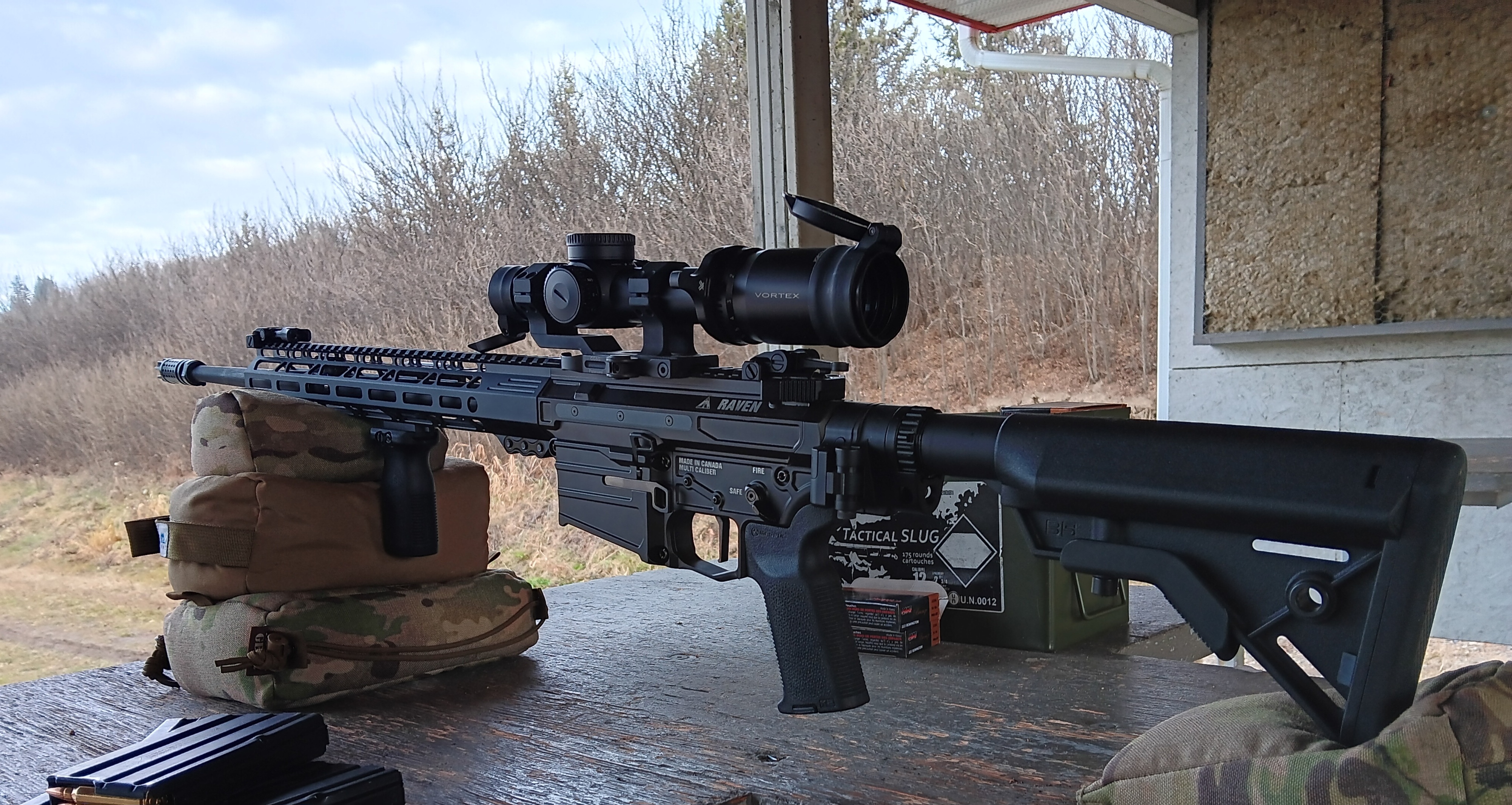

Took advantage of the decent November weather (+7C) to put some more rounds through the Raven. Fired another 160 rounds for a total of 440 rounds to date with zero stoppages. No need for any adjustments today - just shot as a continuation of the last session. I continue to be impressed with the Raven. It is without question a step above every other Canadian manufactured rifle, all of which are based on the AR180B piston operating system. Just as the AR15 was a step above other designs, so too is the Lockhart Raven DI rifle.
