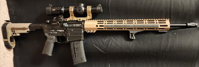

Another 200+ rounds down-range today, with various fellow gunnies test-driving the Raven 5.56mm alongside my 14" Bren 2. The Raven never faltered and as a result of its soft recoil impulse, balance and reliability it garnered very positive reviews from all who tried it. The Raven wins hearts and minds wherever it goes!
I am now over 700 rounds and counting, without a single malfunction. Not too shabby.

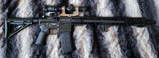

Good question, as the calibre exchange kits don't seem to come with any particular Buffer system. What weight of Buffer comes with the Raven 9mm? H? H1? I aam running an H2 Buffer on a Geissele "Super 42" braided extra power spring, as the factory H1 Buffer that came with my Raven 5.56mm was experiencing Bolt-Carrier "bounce" upon closure.
