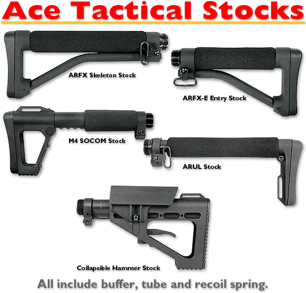

I've seen some ebay knock off of the ARUL stock for around $60 US. At that price, its getting close to the MFT stock. Need to find a seller who will ship to Canada.
