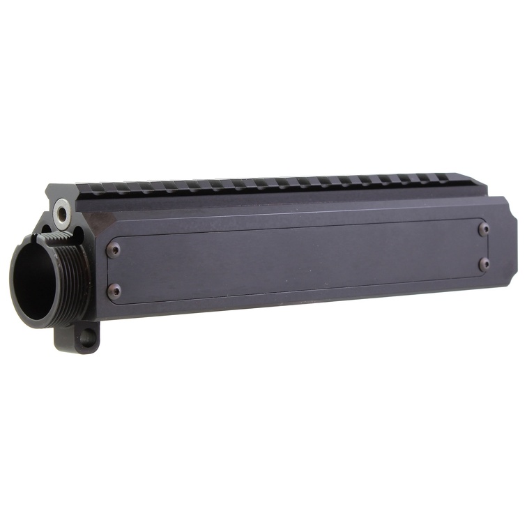

Left hand charge uppers are in stock now and ready to order.
Right hand charge uppers are finished, we just need to assemble them, do product photos and add them to the site. Should be ready to order tomorrow afternoon.
